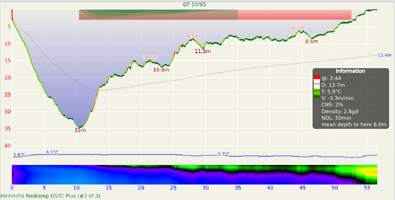

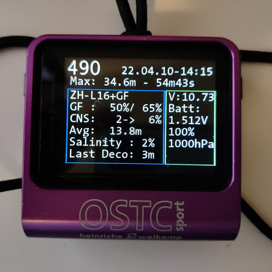

I did some dives with my new OSTC Sport (running hwos sport 10.73) with fairly conservative settings, GF 50/65. On the first dive it was fairly close to my Garmin watch with the same gradient factors. However, on the 2nd dive I had to get much shallower for the OSTC to start counting down the deco time.
On the first dive the OSTC is pretty close to Subsurface's ceiling and the Garmin is in the same ballpark.
On the second dive the Garmin and Subsurface are pretty close:
The OSTC is much slower though. It doesn't end the deco until Subsurface reports a surface GF of 60.
Is this the expected behavior or is something off for the 2nd dive? Did I just accidentally end up with a profile where the OSTC didn't think I was off-gassing the leading tissues, while the Garmin and Subsurface just happened to end up on the other side?

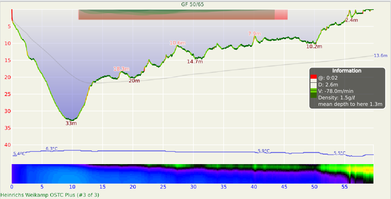

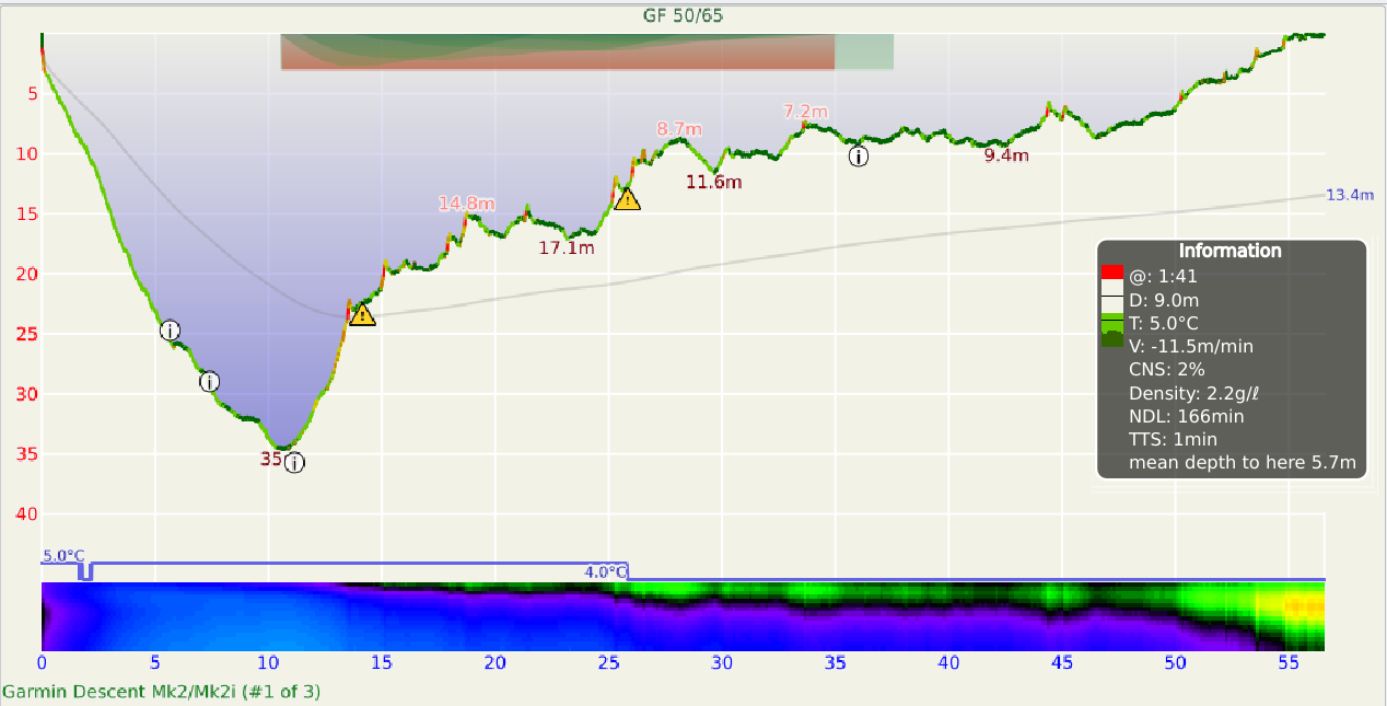

Yea, I think there some real misunderstanding with the data I'm trying to present. Might be that you're not familiar with how Subsurface displays the information. Or something else is wrong (I do notice that the order of the images is wrong when watching the thread under the reply editor compared when just watching it normally).
There are 3 graphs in my first post. The first one is from the first dive. Since I only could attach 3 images i used the OSTC, but the Garmin looks very similar. The red bar is the deco ceiling according to the dive computer, it ends at around minute 45. The green bar is the deco ceiling according to subsurface, it ends just before, at around minute 43. These are all reasonable differences. If a do a plan like 30 min at 30 m on Air on the Garmin and OSTC they end up with very similar run time and stops. The calculations for the first dive is not in question, they are all within the same ballpark. It's the 2nd dive that is the issue.
In the 2nd graph you can see Garmin log for the 2nd dive. The dive computer ceiling ends at minute 35 and the one calculated by Subsurface ends at around minute 37.
In the 3rd graph you can see the OSTC log for the 2nd dive. There the dive computer ceiling ends at minute 52 and the one calculated by Subsurface ends at around minute 35. Here is the log according to the OSTC itself:
During the dive,as the Garmin was just clearing its deco obligation at around the 35 min mark, I was at a depth of around 8-9 m and the OSTC was still showing the same 5 minute stop that it had counted up to earlier during the dive and the @+5 showed the same TTS. According to the log it seems to take a bit more than 5 minutes to decrease the deco time by 1 minute, so it is off-gassing, but not fast enough for @+5. Very much slower than the off-gassing that Garmin and Subsurface calculated though.
I don't have access to a Shearwater, but if people have done repetitive dives with it and the OSTC and compared to the Subsurface calculations, then it would be very interesting to see. With less conservative settings you could compared the saturation at the end of the dive, instead of cleared deco ceiling, and see if it matches up. I got distracted when surfacing so only have the saturation from when the log was saved 10 minutes after surfacing. If it would turn out that Shearwater and OSTC largely agree and are this different from Subsurface and Garmin on the 2nd dive, then I would really like to hear about it.

Well, i'm probably at my limits in helping you. I'm not that familir with subsurface, but what puzzles me is 3 things i cannot align:
- above you wrote you are doing NDL dives with not stops,
- but the OSTC logbook screenshot showes a deco obligation, i.e. it was a deco dive (at least with a GF high at 65%, with 100% original Bühlmann maybe not)
- i don't know exactly what the bar and its colors at the top edge of the subsurface plot mean, but as it ends abruptly it seems to be the 3 m deco stop and not a ceiling curve, so i see no information on how the ceiling depth evolved along the dive.
Where does the bar at the top edge of the subsurface plot origin from: from the dive computer log, or from Subsurface calculation?
The OSTC will clear the last deco stop when the ascent calculation yields that on arriving at the surface the leading tissue will be at GF high. Sometimes you may read that the leading tissue reaches GF high at the last stop, but what is wrong because when doing a linear projection from GF low at the first deco stop and GF high at the last, there will be a leading tissue's pressure > GF high at the surface.
As your dive seems to be a deco dive, with one stop only at 3 meters, your GF low of 50% will have locked onto the 3 meters stop and your surfacing was controlled by the GF high of 65%. As you stayed at 8-9 meters if i remember right, the extra 5 to 6 meters do slow down the offgassing which explains why the @+5 mins do not give a smaller number. The TTS always assumes you are starting your ascent now (or in @+X minutes for that 2nd deco calculation), i.e. go up to the indicated 3 meters in this case and then follow the issued deco plan. As you stayed deeper, you pushed the deco clearing with you towards later times. I don't know how other Bühlman with Gradient Factors implementations handle the case when the 1st stop is equal to the last stop regarding GF low / GF high application, but above is how the OSTC does it and it yields a smooth transition from NDL to deco.

The bar at the top edge has two sources. The red part comes from the dive computer log. The green one is calculated by Subsurface on the data in the log + it takes into account previous downloaded dives. You can see the the ceiling for individual tissues as curves earlier in the bar as darker shades. They quickly go down to almost 3 m and then slowly go back to the surface, with different tissues having the lowest ceiling. The green 3 m bar continues until all ceilings have reached the surface, but if you hover over the graph in Subsurface the actual deco calculation in the information window shows that deco is cleared a few minutes earlier and the target GF high will be reached when surfacing.
The question is really about tissue loading and off-gassing. You write that OSTC will clear the deco when it thinks that the target GF high will be reached upon surfacing. In the second dive this would happen at around 32-35 minute mark according to both Subsurface and Garmin (once I get to above 10 m it takes about 10 minutes to clear the 3 minute deco) , while for the OSTC it takes until minute 52 to reach the same GF high. So what I'm wondering is why the off-gassing seems to be so much slower at 8-10 m, or the tissue loading so much higher. It could of course be that both Subsurface and Garmin are way too fast in off-gassing or too low in tissue load, but with the data I have it's OSTC that stands out.
