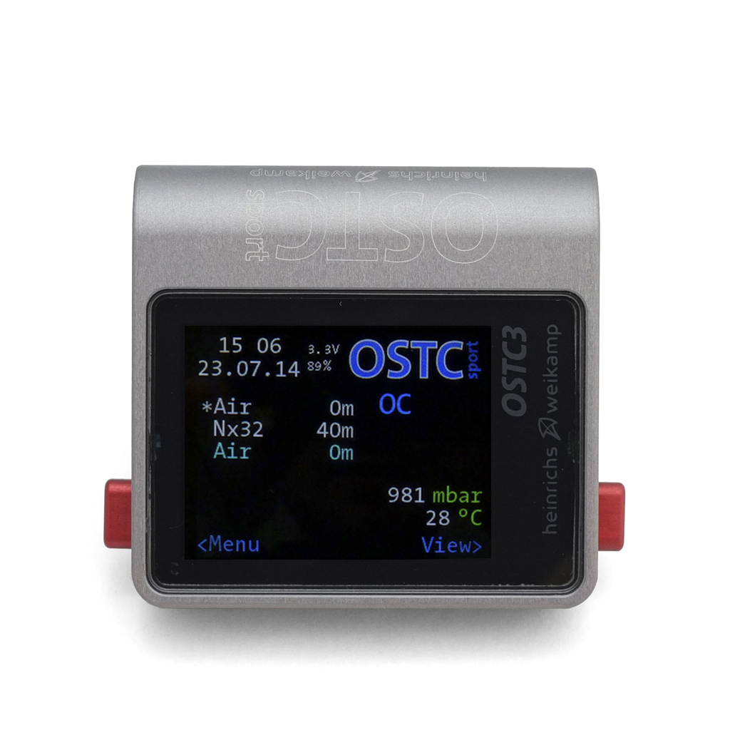

T4 and "OSTC sport" does not fit.
Do you have have an OSTC2?
That's an OSTC sport: That's an OSTC 2 (Mod. 2017): regards,
Re: OSTC Sport Dive M2ode Switch-on
Yes, you are right, it is an OSTC2 as in your photo. Sorry for confusion.
