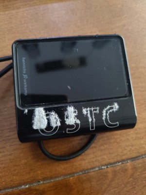

Hello I have been diving with my OSTC4 in salty water for only 26 hours total (25 dives) and It has been developing a weird corrosion over the OSTC letters

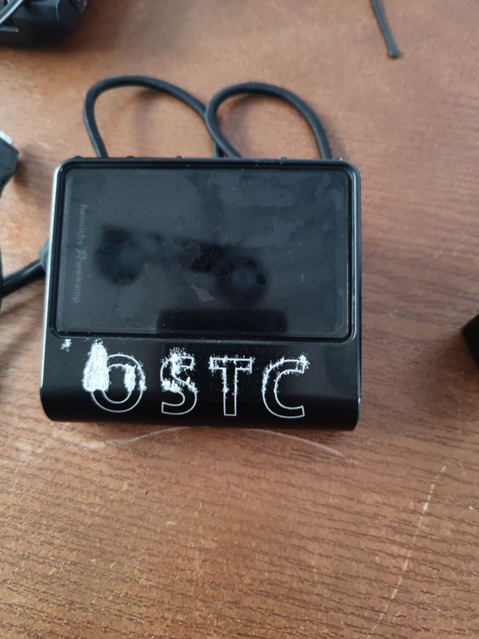

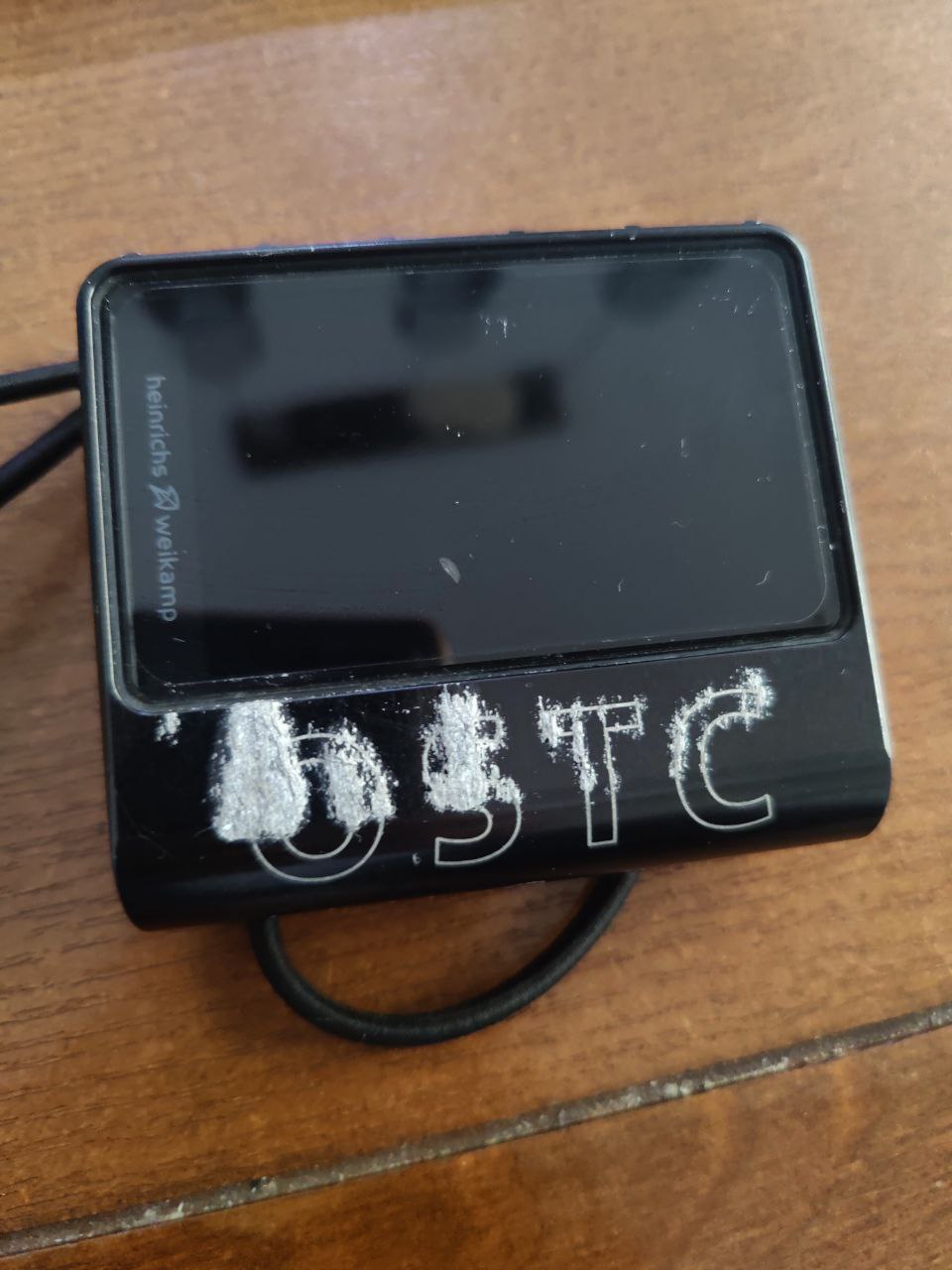

a few dives more

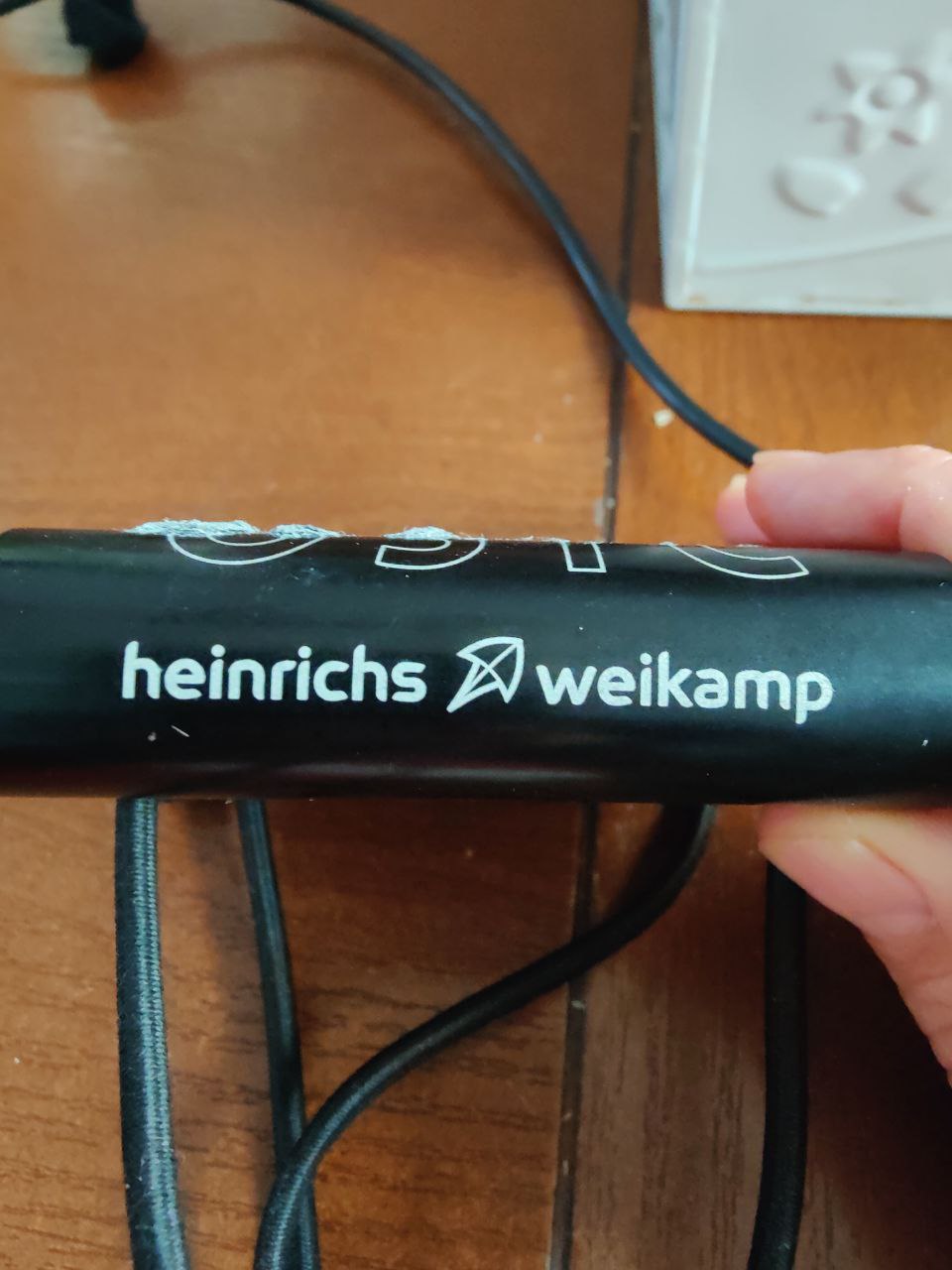

The corrosion does not seem to affect the side of the computer but also is bulged out. as can be seen on the following image Of course, I wash my computer with fresh water after every dive.
Has anyone had the same problem?
What should I do?

Re: Corrosion on the OSTC4
Yes, I have the same problem. I removed the corrosion
and applayed aluminium grounding and coating, but it comes again. It seems to be only on the front of the battery compartment. The only i can imagin, is, that it is an electrolytic
corrosion as i see also on my boat. Maybe there is electric power running through the housing ?

Interesting is also, that the corrosion is around the letters over
the battery compartment. This also needs an investigation why it is so.

It’s the only place on the housing there is etching into the anodising. Could be related to the battery but could just be coincidence
