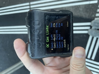

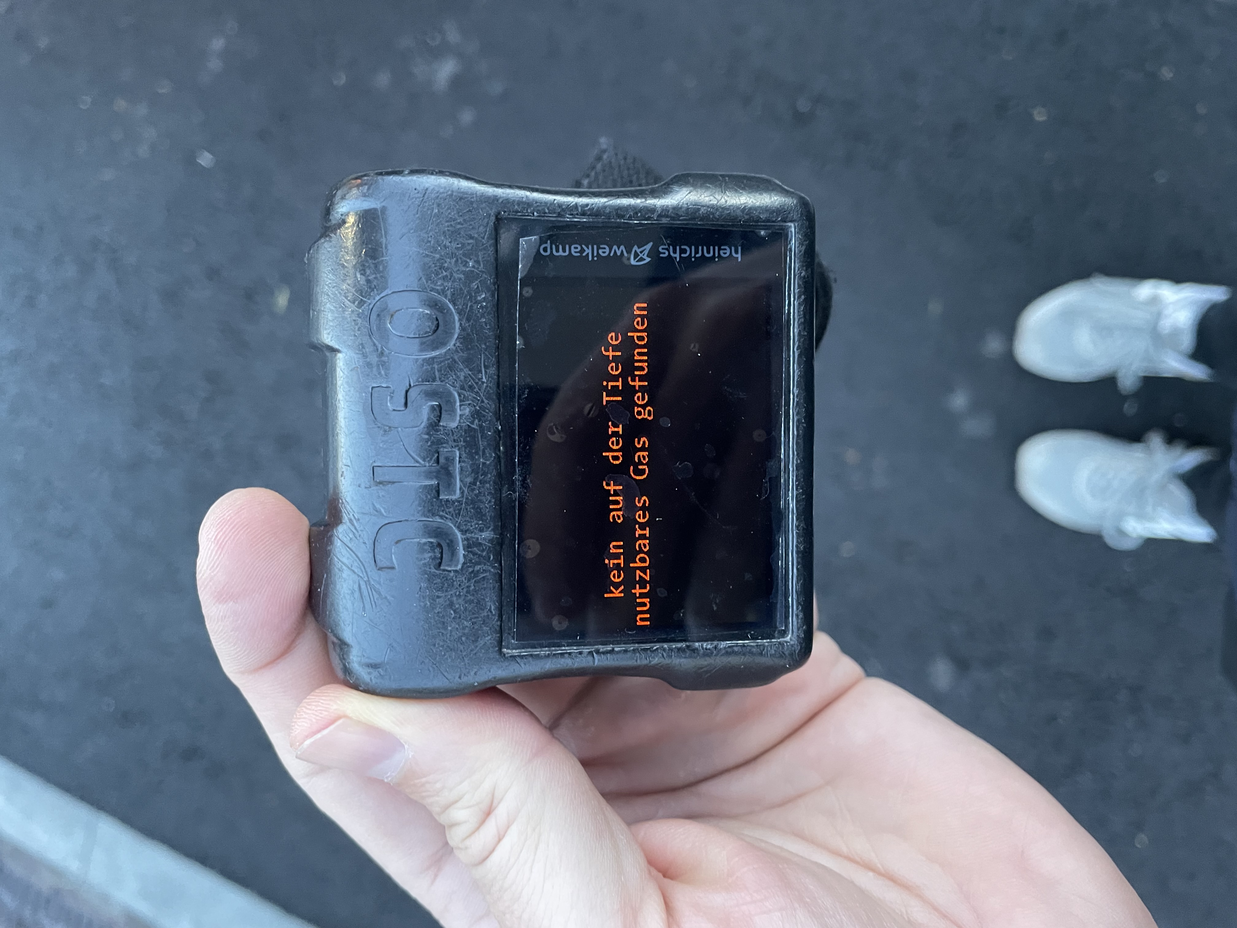

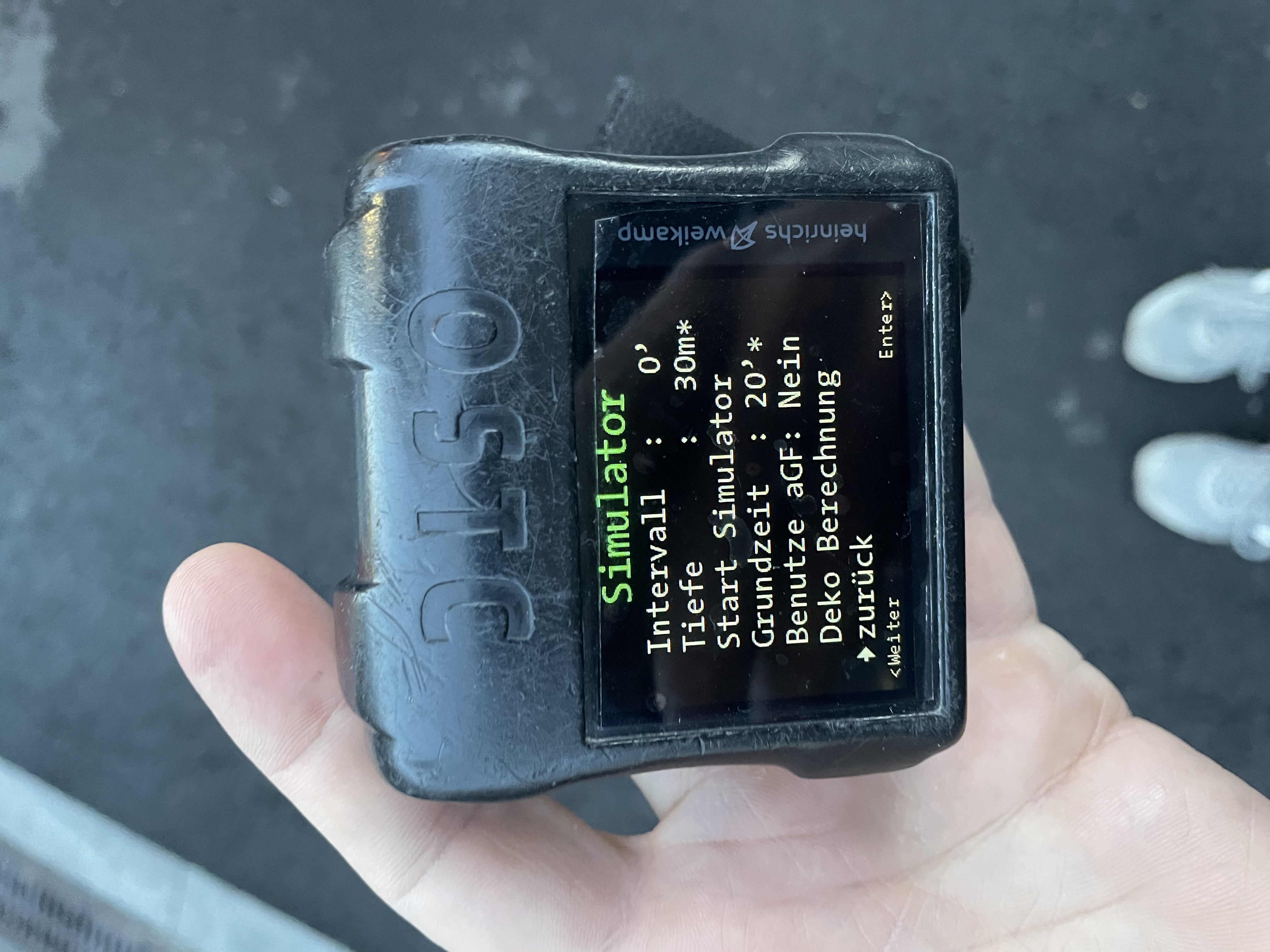

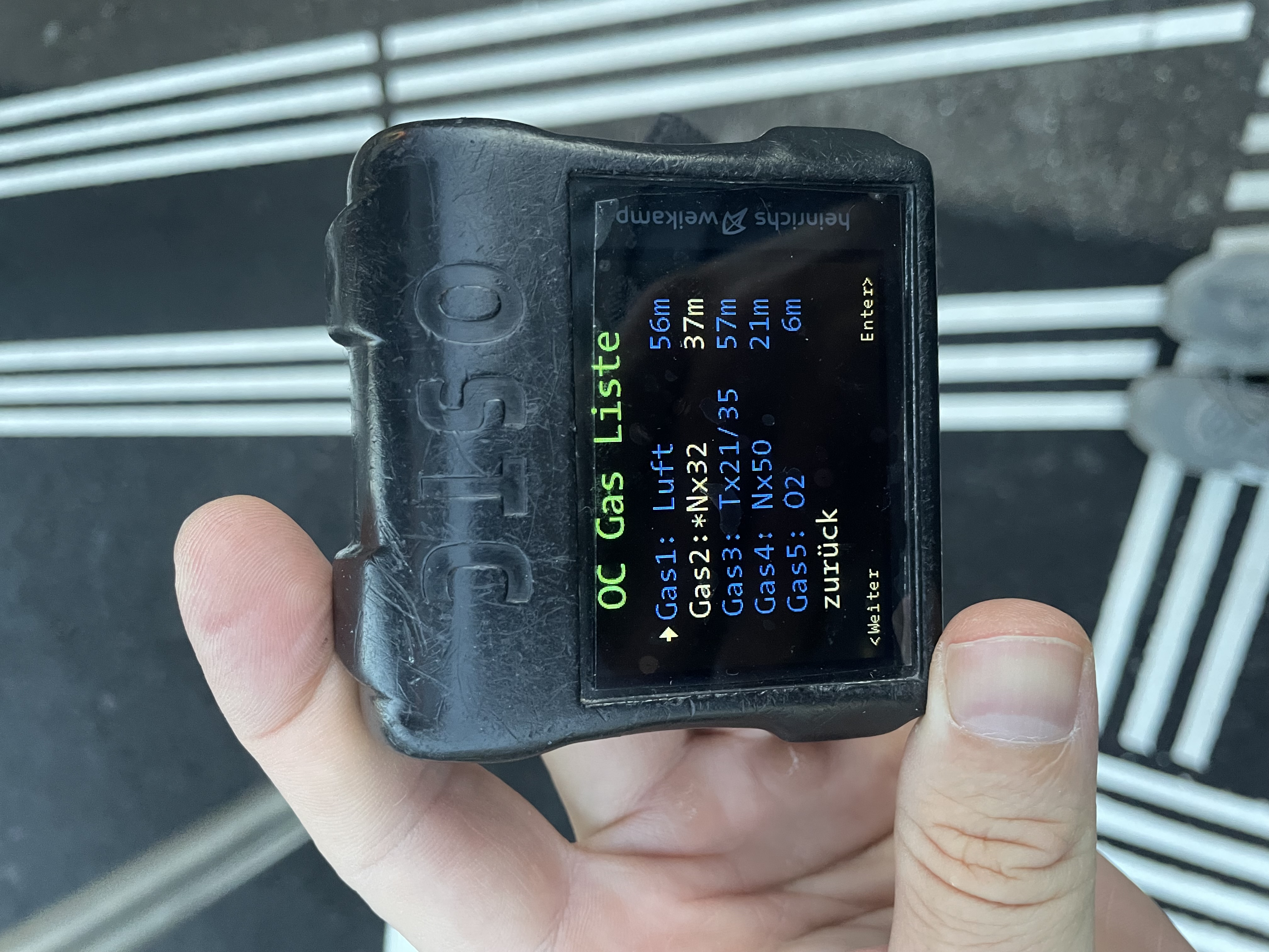

Hi
Firmware 3.24
I wanted to plan a followup dive. After clicking on deco calculation, I got an error ‚no breathable gas at depth‘ for a 30m dive, even though I have Nx32 with MOD 37m configured. 24m works.
see attached screenshots.

Please check your max ppO2 setting. I suspect 32% 30m aka 4 bar ambient pressure exceeds the current max work ppO2.

Perfect, increasing the working pO2 fixed the issue!
