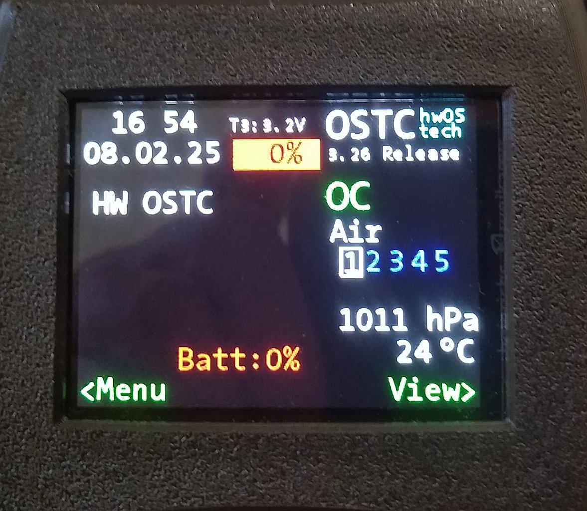

Just after updating firmware on my OSTC2 (3.19 to 3.26), the battery graph indicate 0% while it is charged at 3.2V ???
See Photo.
What's the problem? Bug? How to solve it?

Hi Emka,
give it a full charge. The battery data reset during the update, it needs an end-of-charging event to calibrate the Bat Indicator for 100%.

Thank's Ralph.
do I need to reset the battery in the system setting menu after the full charge?

No, just make sure the correct battery type is selected (see the manual). The computer uses the T1, T2, T3,... settings to know the capacity and the voltage drop vs. discharging state to calculate the batt %.
