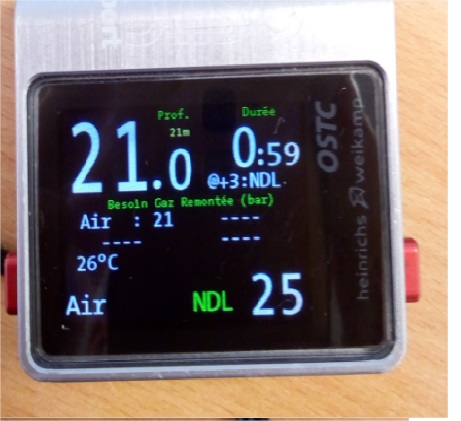

I put a sample of a simulation in the attached files : Bloc 15l 210b => in the simulation prof 21m for 1'. No dec time . The computer indicate needed gaz to ascend = 21 bar ?? I don’t understand because in reality we need about 5-6 bars

Your guessing is completely right! Anyhow, there are three more infos you need to have to fully understand trhe function:
1) The SAC rate (l/min breathing rate at 1 bar) needs to be configured. For the part of the ascent before the first stop ("Initial ascent"), the SAC work will be used, at and after the 1st stop the calculations will use SAC deco.
2) The gas needs calculation will always pick the best gas. To decide which gas is the best one, the algorithm only looks at the change depths of the gases. So if you configure a Nx50 with change depth 30 meters, calculations will pick the Nx30 once passing 30m. In other words: it doesn't look at the resulting ppO2. Anyhow, in case you actually would switch to that gas on that depth, the OSTC will prompt you a big warning.
3) Last but not least, when you have set a fTTS time, the calculations will figure in the amount of gas you will consume on the current depth for the fTTS delay time before doing the ascent. The idea behind is to use the fTTS time to have the gas included that is needed between deciding to end the dive (or having an event that will force you to turn the dive) and actually starting the ascent, e.g. to signal to the buddies, send an SMB, etc. This gives the unexpeced extra in your numbers.

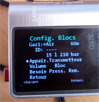

Otherwhise, when you say: "when you have set a fTTS time" is it a set up in simulation mode? or in your mind?
I'm not very sure of your meaning of "fTTS time" => My problem is : I have my firmware in french
And in the menu Config Tank or for me in french "config BLocs (see my picture) i am not sure of the meaning of "besoin press. Rem."'
If i translate in english => need pressure ascend
Is it only the securtity reserve we want to keep after the dive ??

The tank pressure you set in the menu, along with the tank size in liters, tells the OSTC how much gas is available. When a computed need reaches 70% of the available amount, a yellow attention message is generated. Upon reaching 100%, a red warning comes on. So it is clever to set the OSTC to a little less pressure than there actually is, so that the red warning does not come right on the edge of tank depleption but a little bit earlier. All given your SAC is also set accurately. For deco tanks, you can set the fill pressure (minus a small delta, as said), for the back gas set your planned turn pressure (minus the delta, again). Example: planned turn press: 120 bar -> set OSTC to 100 bar, so will get the first attention when the ascent is computed to take 70 bar and the warning on 100 bar, leaving you with a final reserve of 20 bar.
