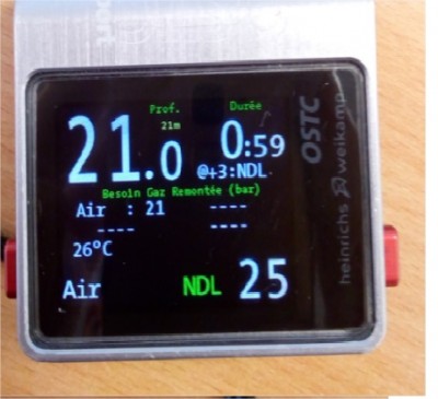

I think we could set up before dive=> the volume and the initial pressure of the tank less the pressure we want keep at the end of the dive? In other words, the pressure avalable to the dive.
And during the dive, the computer predict the needed in bar to the ascend, and give an advice at the buttom when there is not enough gaz?
I put a sample of a simulation in the attached files : Bloc 15l 210b => in the simulation prof 21m for 1'. No dec time . The computer indicate needed gaz to ascend = 21 bar ?? I don’t understand because in reality we need about 5-6 bars
Many thanks if someone could explain this menu

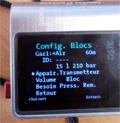

Otherwhise, when you say: "when you have set a fTTS time" is it a set up in simulation mode? or in your mind?
I'm not very sure of your meaning of "fTTS time" => My problem is : I have my firmware in french
And in the menu Config Tank or for me in french "config BLocs (see my picture) i am not sure of the meaning of "besoin press. Rem."'
If i translate in english => need pressure ascend
Is it only the securtity reserve we want to keep after the dive ??

The tank pressure you set in the menu, along with the tank size in liters, tells the OSTC how much gas is available. When a computed need reaches 70% of the available amount, a yellow attention message is generated. Upon reaching 100%, a red warning comes on. So it is clever to set the OSTC to a little less pressure than there actually is, so that the red warning does not come right on the edge of tank depleption but a little bit earlier. All given your SAC is also set accurately. For deco tanks, you can set the fill pressure (minus a small delta, as said), for the back gas set your planned turn pressure (minus the delta, again). Example: planned turn press: 120 bar -> set OSTC to 100 bar, so will get the first attention when the ascent is computed to take 70 bar and the warning on 100 bar, leaving you with a final reserve of 20 bar.
