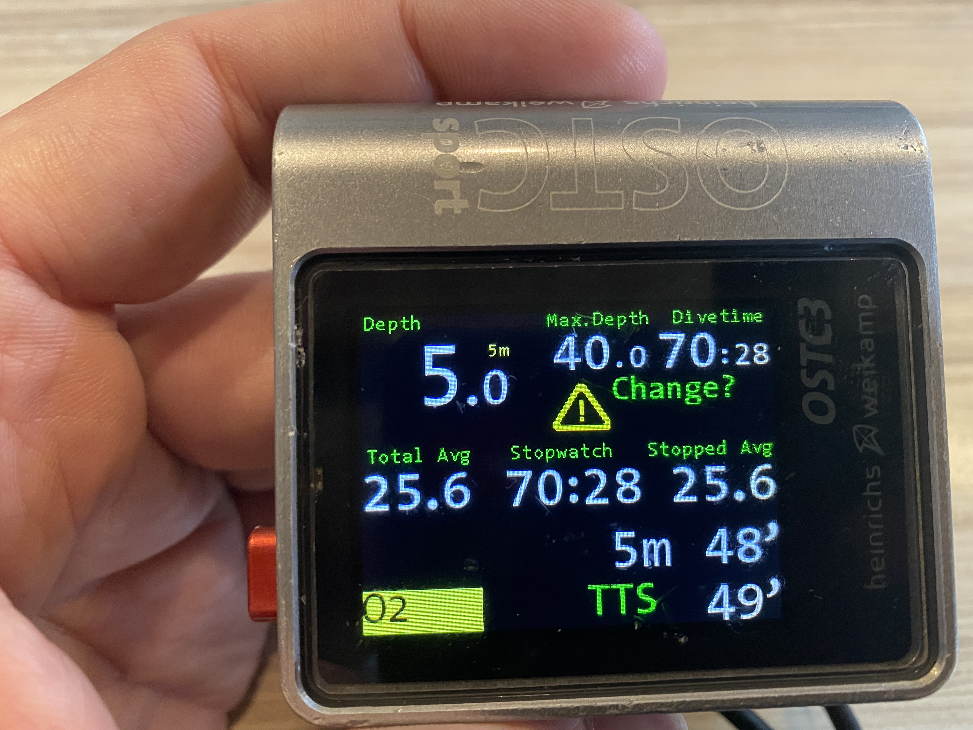

[attachment=0]IMG-2843.jpg[/attachment]
Maybe due to simulator mode but I tried to switch a gas which was not configured.
From the display I understand that I selected the gas but not confirmed to change. How can this be done ?
Thanks in advance for your help.

Not sure about the change, hard to tell from photo.

Picture: 2843: you are on O2. You are always in the gas that is shown in the lower left. Anyhow, the O2 seems not be propperly configured redarding change depth, so the OSTC thinks there is a better gas available und subsequently prompts you with a gas change advice (green) and marks the current gas (the O2) in yellow as something you can improve your dive on.

I am quite troubled on this one. Again this was done in the simulator. I followed following steps: Only one gas (air). At 6m I configured O2 (as if I received it from someone else via Gaslist - More) manually - the deco did not improve and the O2 remained in yellow - I understand that the OSTC keeps proposing air as better alternative. might be something linked to the simulator mode although.Picture: 2843: you are on O2. You are always in the gas that is shown in the lower left. Anyhow, the O2 seems not be propperly configured redarding change depth, so the OSTC thinks there is a better gas available und subsequently prompts you with a gas change advice (green) and marks the current gas (the O2) in yellow as something you can improve your dive on.
When trying with O2 as disabled gas it seems happy but the deco time does not seem to reduce.

[quote]Picture: 2843: you are on O2. You are always in the gas that is shown in the lower left. Anyhow, the O2 seems not be propperly configured redarding change depth, so the OSTC thinks there is a better gas available und subsequently prompts you with a gas change advice (green) and marks the current gas (the O2) in yellow as something you can improve your dive on.[/quote]
| Simulator or real dive dosn't matter, the simulator is 100% like how the OSTC behaves in real diving. When you are on the extra gas (aka "gas 6" in older nomenclature) the OSTC doesn't have depth and gas type Information on it. So it can not figure out of this extra gas or the regular gas 1 is better. So you need to set the gas 1 as 'lost' via the Gaslist menu to tell the OSTC that this gas is no option. This touches a point in the programming code that has been worked on lately, but the updates have not been released yet.
| When using O2 from the list of configured gases, look out that its Change depth and type (deco) is set correctly and that your ppO2 margins allow for pure O2 from 6 meters. If there conditiosn are met, the deco calculation will already figure in the use of O2, that's way you get no change in the TTS and stops when you Change as soon as the O2 becomes breathable. Indeed, so will so TTS and stops obligation go up if you do not change...

Regarding the extra gas (aka "gas 6") I understand that I should configure it first and then mark Gas 1 as lost. This indeed changed the deco time.
Regarding my reference to O2 from the list of configured gases. I should have stated that it is configured but disabled. From the simulation I made, It seems that the OSTC only recalculates the deco time when I mark the main gas as lost. I would have expected that the deco is reduced when selecting this disabled gas directly.. whithout marking the "enabled gas" as lost
If the O2 is marked as available it is considered for the calculation and it there is not change in deco time as already considered as from the beginning.

For the gas changes I will make more simulations when the new firmware is out as I understand that there has been some changes on this.
