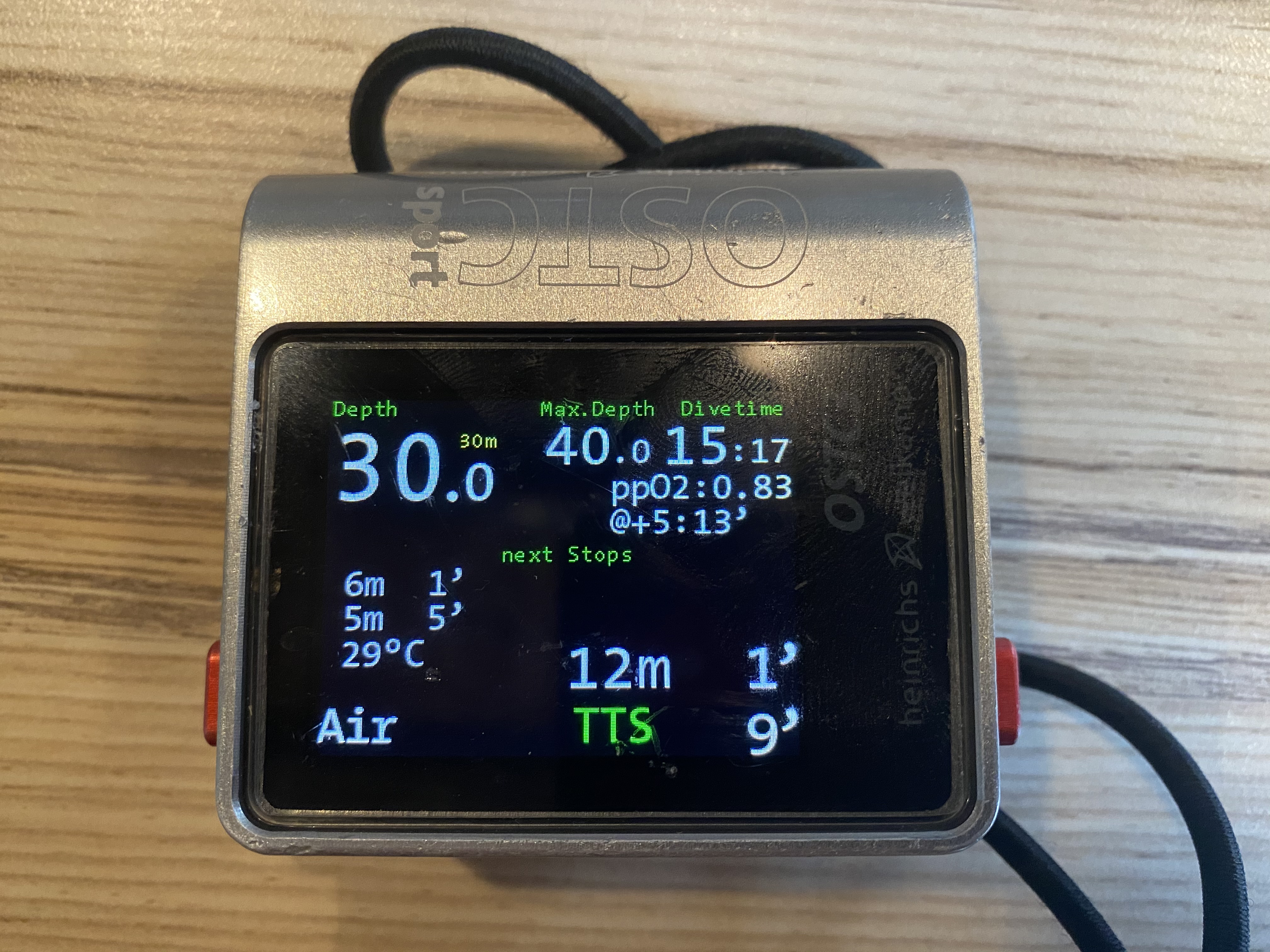

[attachment=2]IMG-2841.jpg[/attachment]
I would expect the TTS to be 1+5+1+3 (30m@ 10m/s)=10 and not 9.. or am i missing something ?

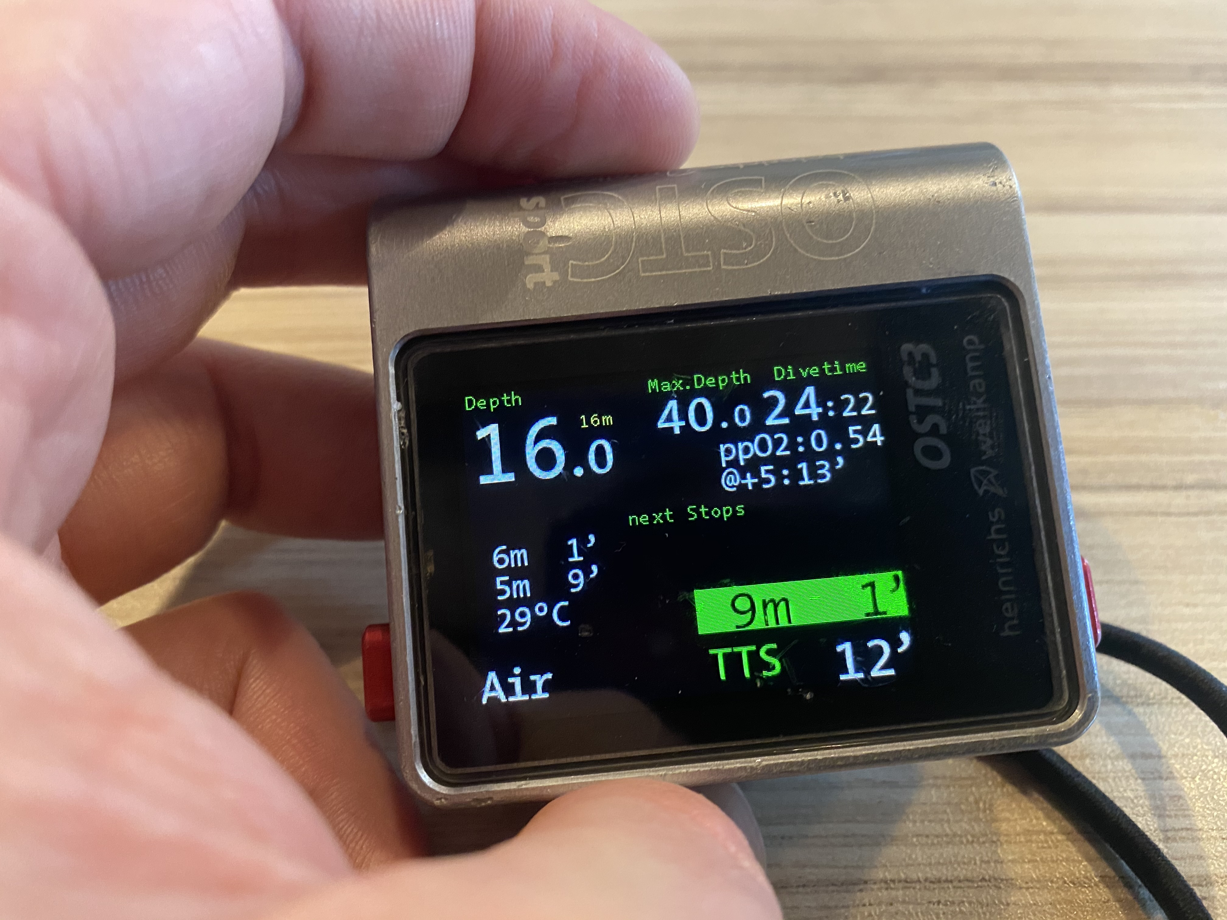

[attachment=1]IMG-2842.jpg[/attachment]
What does the green highlight mean?

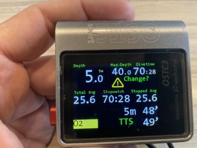

[attachment=0]IMG-2843.jpg[/attachment]
Maybe due to simulator mode but I tried to switch a gas which was not configured.
From the display I understand that I selected the gas but not confirmed to change. How can this be done ?

Green background means you are shallower than the depth of the deco stop. Need to go closer to the depth. IN this case you are at 16 m and need to be at 9 m. I think the green displays if you are more than 0.5 m deeper than the stop.

regarding picture 2841: you have 2 stops, 1 and 5 minutes, and will need 30m/(10m/min) = 3 minutes for the ascent. This totals to 9 minutes. Where do you exect your extra 1 minute to come from?
Picture 2842: green color stands for an information on something "positive" or a hint to do something. In this case, it prompts you that you can ascent to your next deco stop.
Picture: 2843: you are on O2. You are always in the gas that is shown in the lower left. Anyhow, the O2 seems not be propperly configured redarding change depth, so the OSTC thinks there is a better gas available und subsequently prompts you with a gas change advice (green) and marks the current gas (the O2) in yellow as something you can improve your dive on.

When trying with O2 as disabled gas it seems happy but the deco time does not seem to reduce.

I am quite troubled on this one. Again this was done in the simulator. I followed following steps: Only one gas (air). At 6m I configured O2 (as if I received it from someone else via Gaslist - More) manually - the deco did not improve and the O2 remained in yellow - I understand that the OSTC keeps proposing air as better alternative. might be something linked to the simulator mode although.Picture: 2843: you are on O2. You are always in the gas that is shown in the lower left. Anyhow, the O2 seems not be propperly configured redarding change depth, so the OSTC thinks there is a better gas available und subsequently prompts you with a gas change advice (green) and marks the current gas (the O2) in yellow as something you can improve your dive on.

[quote]Picture 2842: green color stands for an information on something "positive" or a hint to do something. In this case, it prompts you that you can ascent to your next deco stop.[/quote]
Ok, I understand that this is just to indicate that I am in the neighbourhood of the my next deco stop. Correct ?
| Yepp, correct
[quote]Picture: 2843: you are on O2. You are always in the gas that is shown in the lower left. Anyhow, the O2 seems not be propperly configured redarding change depth, so the OSTC thinks there is a better gas available und subsequently prompts you with a gas change advice (green) and marks the current gas (the O2) in yellow as something you can improve your dive on.[/quote]
| Simulator or real dive dosn't matter, the simulator is 100% like how the OSTC behaves in real diving. When you are on the extra gas (aka "gas 6" in older nomenclature) the OSTC doesn't have depth and gas type Information on it. So it can not figure out of this extra gas or the regular gas 1 is better. So you need to set the gas 1 as 'lost' via the Gaslist menu to tell the OSTC that this gas is no option. This touches a point in the programming code that has been worked on lately, but the updates have not been released yet.
| When using O2 from the list of configured gases, look out that its Change depth and type (deco) is set correctly and that your ppO2 margins allow for pure O2 from 6 meters. If there conditiosn are met, the deco calculation will already figure in the use of O2, that's way you get no change in the TTS and stops when you Change as soon as the O2 becomes breathable. Indeed, so will so TTS and stops obligation go up if you do not change...

hm....Ralph wrote: 09 Feb 2020, 17:54From the 1min deco @12m -displayed in big as first stop - obviously I might have missed something.regarding picture 2841: you have 2 stops, 1 and 5 minutes, and will need 30m/(10m/min) = 3 minutes for the ascent. This totals to 9 minutes. Where do you exect your extra 1 minute to come from?
| Uups, i overlooked the 12 meter stop. You are right with your sum. I Need to look into the code again as the way the TTS is calculated in detail changed over the cource of the last years. It may be due to rounding and that the final ascent from 5 meter to surface doesn't get counted in the TTS any more.
nope.
30m -> 1st stop = 2'
1'@12m
1'@6m
5'@5m
tts=9'
but the ascent-time 12m -> 6m ~ 0,5' and 5m -> 0m ~ 0,5' is ignored?

So, had a look into the code, it calculates as follows:
2 minutes to go from 30 m to 12 m (1 minute for each 10 meter section begun)
1 minute at 12 m
1 minute at 6 m
5 minutes at 5 m
9 minutes
The final ascent does not get counted. Older firmwares calculated 1/2 minute (10 m/min) rounded up to 1 minute, or switched to an ascent speed of 1 m/min and thus would have added 5 minutes. Both is somehow to the extremes. So now TTS is kinda "Time to done with Deco" and it is left to the diver how fast (or better slow) he does the final ascent.
The upcoming 3.08 Firmware will calculate the initial ascent in 1 meter sections, which will give a better rounding and will also solve the instability issue with the depth of the 1st deco stop.
