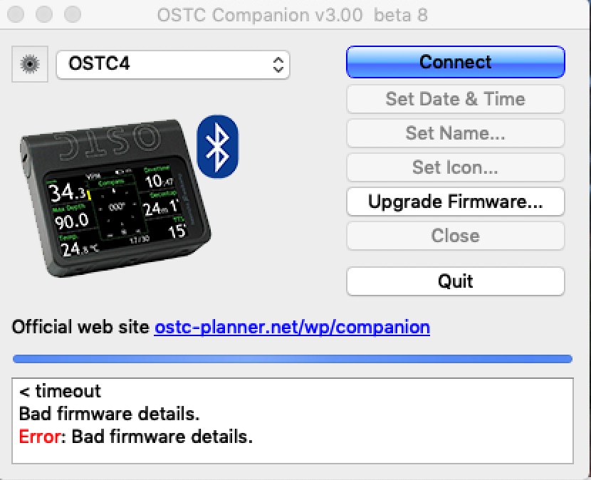

I am having trouble with the upgrade.
This is what happens:
After starting the upgrade the OSTC displays "uploading part one" as usual. As soon as the progress bar in companion reaches 60%, the display switches between the regular screen, the message "download mode enabled" and "service mode enabled".
After 15 minutes the whole things stops and I get one of two time out messages on the companion (see attached screen shots).
What do I do now?
Thanks for your help and stay healthy!

oh, I forgot to mention: I have unit no 198 and FW 1.5.1

I had that problem too. I had to reconnect (several times) and start the install again. Eventually it ran through. I am still convinced HW should never have switched to BT. USB is much more reliable.

I tried 5 times so far. Will keep going....

And now it worked. As swissdiving commented, you have to try numerous times which in my case was about 10 times.

Try with the most recent 3.2.1 Companion, please: viewtopic.php?f=7&t=22012
