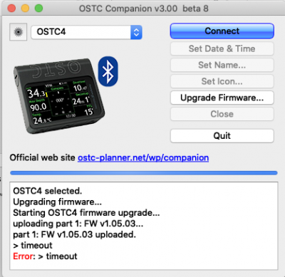

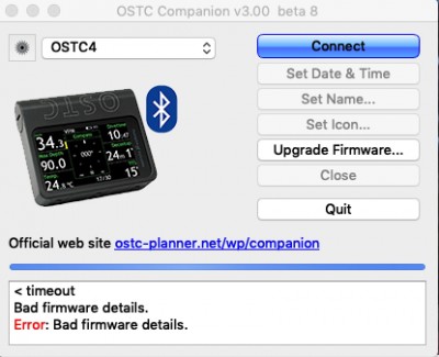

Hi there,
I am having trouble with the upgrade.
This is what happens:
After starting the upgrade the OSTC displays "uploading part one" as usual. As soon as the progress bar in companion reaches 60%, the display switches between the regular screen, the message "download mode enabled" and "service mode enabled".
After 15 minutes the whole things stops and I get one of two time out messages on the companion (see attached screen shots).
What do I do now?
Thanks for your help and stay healthy!
Cheers
ebertalex

oh, I forgot to mention: I have unit no 198 and FW 1.5.1

I had that problem too. I had to reconnect (several times) and start the install again. Eventually it ran through. I am still convinced HW should never have switched to BT. USB is much more reliable.

I tried 5 times so far. Will keep going....

And now it worked. As swissdiving commented, you have to try numerous times which in my case was about 10 times.
