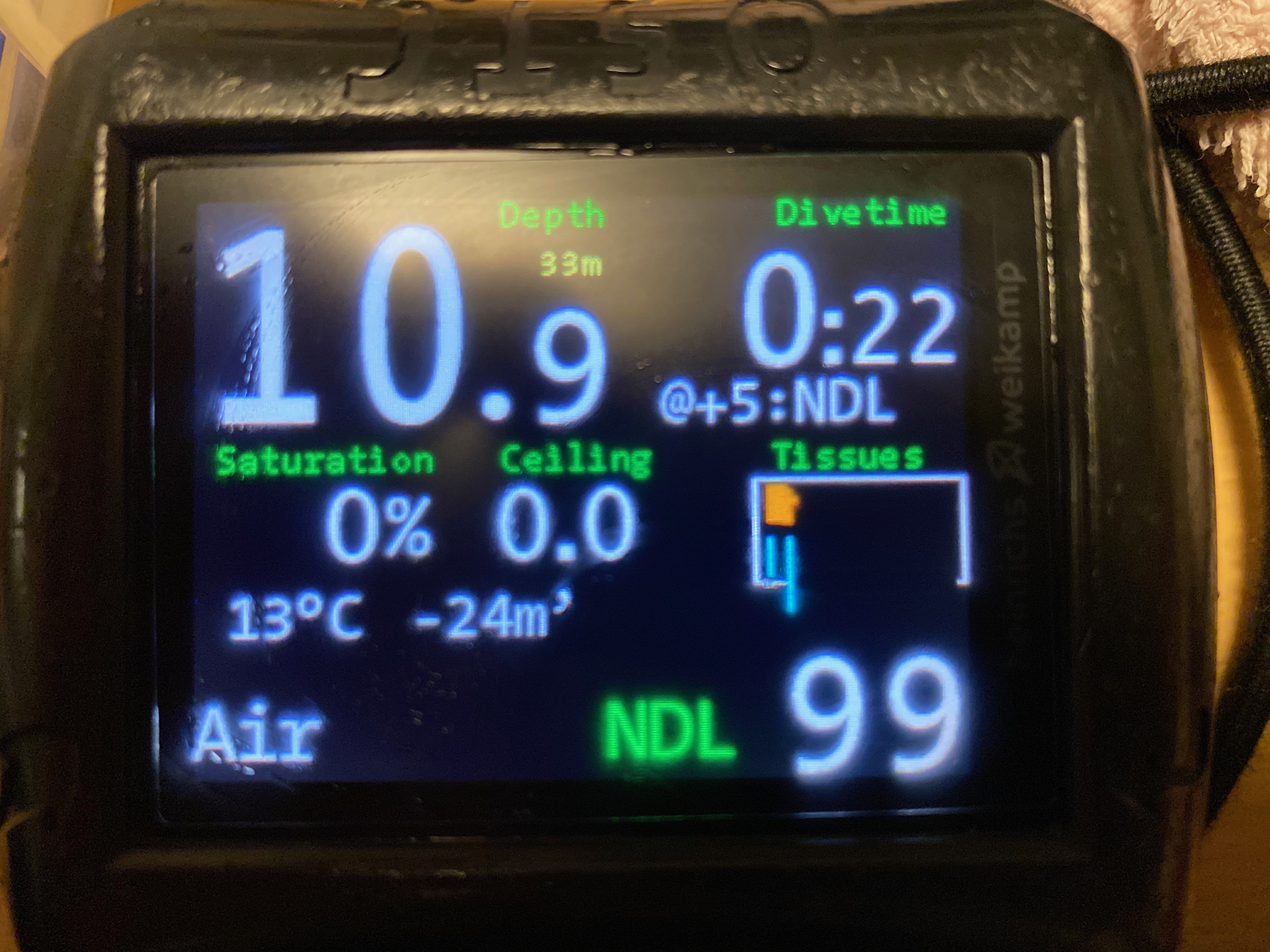

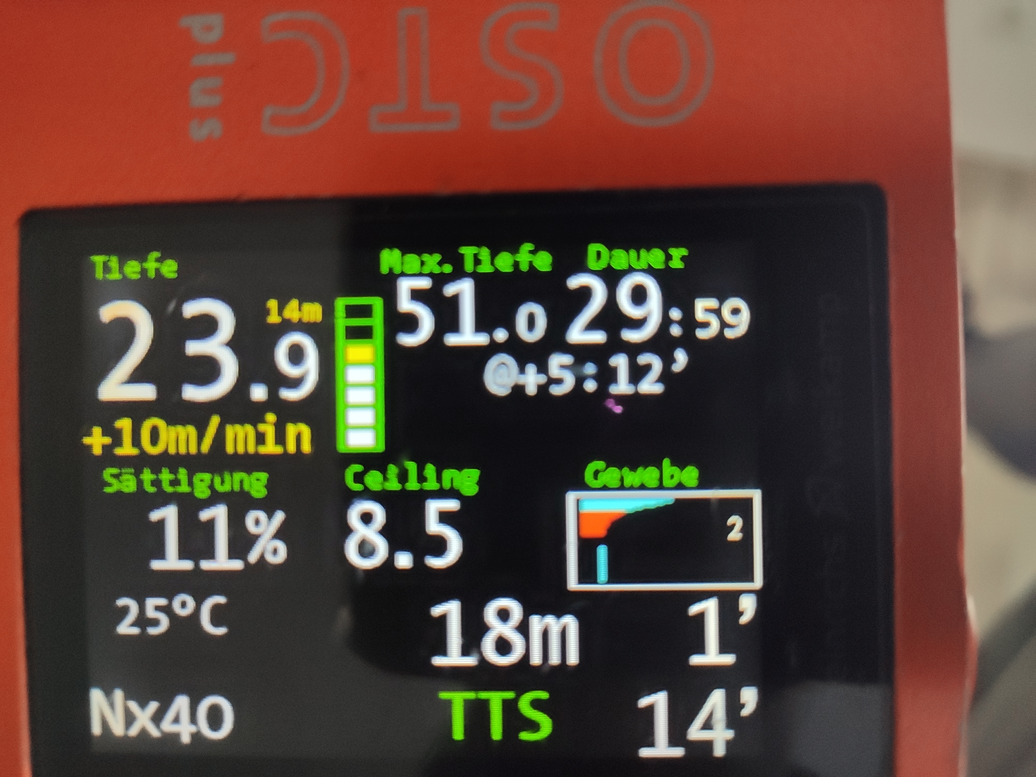

did i dive today. Everything worked fine, despite a little graphical bug.
- Screen layout: large
- Graphics: N2+He
On the screen in dive mode with the tissues, you can notice blue line is outside the white box, the white box is cut. It is also visible when deco is reached... picture is from simulator

Hi Alex,
thanks a lot for your report. I can conform it is "just" a nasty graphical bug without any undesired side effects. Anyhow, fixing is under way...

We fixed it, please reload the firmware from the website (Or in the Update App).
Release date in the information menu should be 30.04.20 then.
Sorry for the trouble,

Just one small comment, on the middle line of the computer where it shows Saturation, Ceiling and Tissues i don't believe this is showing saturation but rather it's showing supersaturation. I know the screen is limited on space so you can't fit the whole word supersaturation in there but just having saturation in there is misleading. What are your thoughts on the words s-saturation or super-sat instead? Now that i know it's not actually saturation it doesn't really bother me too much but i thought it was worth discussing.
Is there a way i can see what my GF would be if i surfaced now? I know i can potentially speed up my deco if required by using an alternate gradient factor set but i'm wondering it it would be useful to see what my GF would be if i decided to cut off some deco and surface early. This only has limited use but i think it does have some use.

thanks for your post. You are correct, technically it is "supersaturation". While even the leading tissue is still in the 'saturation' range, the displayed value is clipped to zero. When going into the supersaturation state, the tissue pressure is higher than the inhaled partial pressure and thus the tissue is starting to decay pressure, indicated by the color change in the tissue diagram and the (super)saturation number going up. There is a strong relation between the supersaturation value and the set GF factors, as the GF factors determin the target value for the supersaturation value while on the way up through the deco stops.
The ceiling depth shown in the middle position gives the depth where a supersaturation of 100% (classic Bühlmann) or a supersaturation equalling the set GF high value will be reached. To answer your 2nd question, the OSTC does not calculate the supersat at depth zero, but the other way around: depth were GF high (or 100%) is reached. If you activate alternative GFs and set the aGF high to 100%, you can probe how much deco depth you would skip if surfacing immediately. Additionally, the tissue diagramm, when switched to 'pres+sat.' mode, will give a live view on how close the tissues come to, or are above, the 100% supersat limit, depicted by the red line. So you can go slowly up above indicated stop depth, taking own control of the deco schedule by looking at the supersat value and the tissue graphics, Actually this whole custom view is designed to have all relevant information in one place to enable an alternative way to control a deco ascent managing supersaturation on one's own, should following the classical 3 meter stop interval scheme not be possible for whatsoever reason (dimishing gas supply, overpopulated deco rig, cave topology, ...)

seit dem neuen Firmware-Update erscheint bei meinem OSTC plus oben rechts nicht mehr die Info Deko Zone (die ftts wurde dann immer grün). Wurde diese Funktionalität entfernt? Oder was muss ich in den Einstellungen ändern, damit dies wieder angezeigt wird?

die Funktion ist noch da. Grundvoraussetzung ist, dass eine fTTS-Berechnung aktiviert ist und beide Deko-Pläne im gleichen Modus berechnet werden, also OC oder CCR ohne Gas-(Bailout-)Berechnung. Im CCR-Bailout-Fall wird nur ein Plan berechnet, dann entfällt die Funktion auch.
Sind alle Voraussetzungen gegeben, dann wird die fTTS-Zeit in grün dargestellt wenn gilt: fTTS < TTS. Weiterhin erscheint dann ein "Deco Zone" Hinweis, der wird allerdings unterdrückt wenn es eine Warnung zur Übersättigung gibt, bei einer aktiven IBCD-Warnung, wenn die aGF aktiv sind und generell im großen Layout (dort gibt es nur eine Zeile für Messages und die (grüne) fTTS- sowie der DecoZone Hinweis würden dann immer umspringen).

Hi Ralph, danke für die Antwort. Ich denke, dass alle von dir genannten Kriterien erfüllt sind. Im Simulationsmodus sehe ich die Deco-Zone Angabe und Grünfärbung dennoch nicht
![Image]()
Wo ist mein Denkfehler

danke für deine Hartnäckigkeit, habe tatsächlich noch einen Fehler im Programm gefunden, der die Grünfärbung und die "Deco Zone" Meldung verhindert hat.

Im Entwicklungsstamm ist es schon gefixt, wir sammeln gerade noch um dann konzertiert die nächste Firmware rauszugeben...
