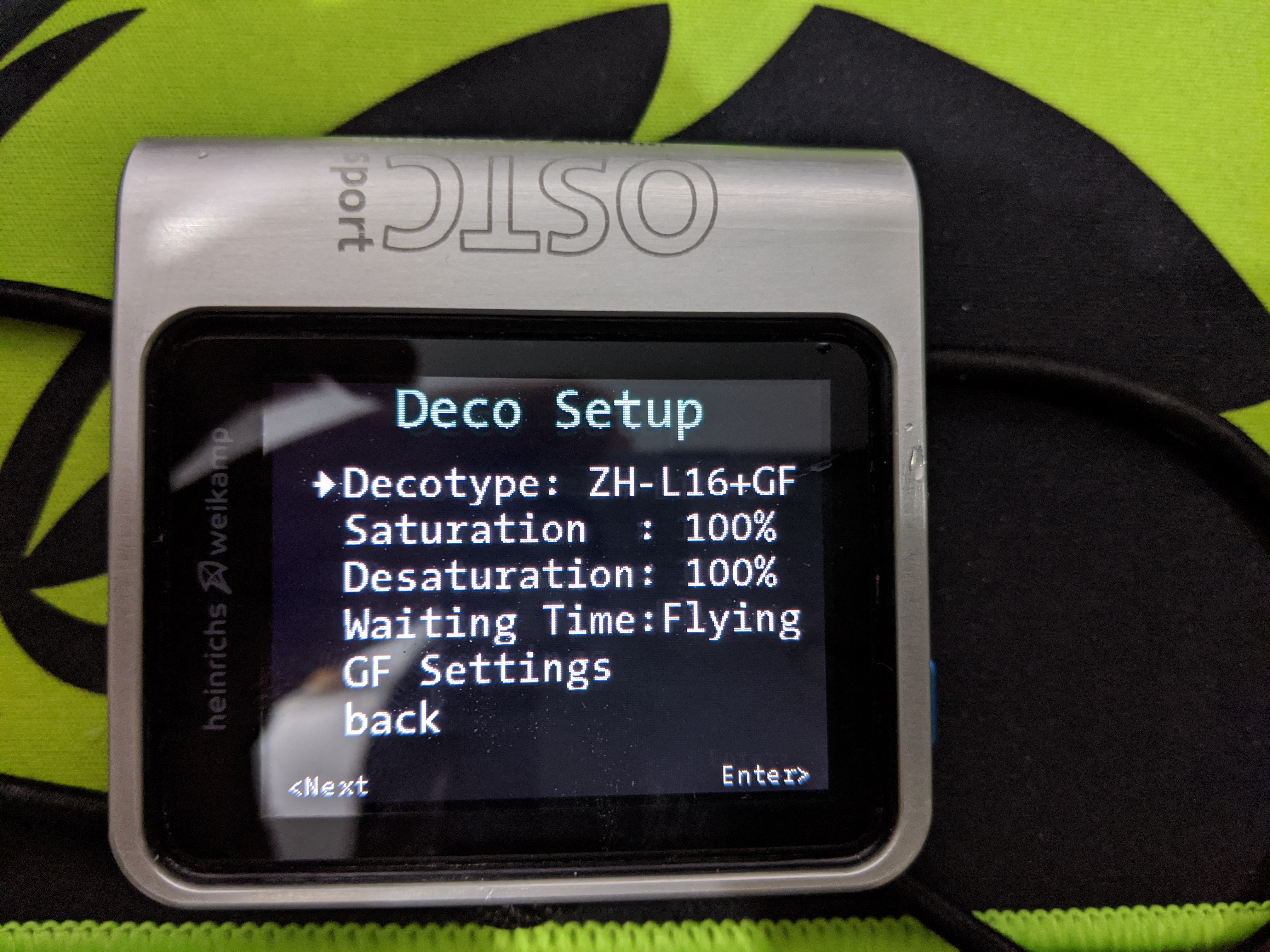

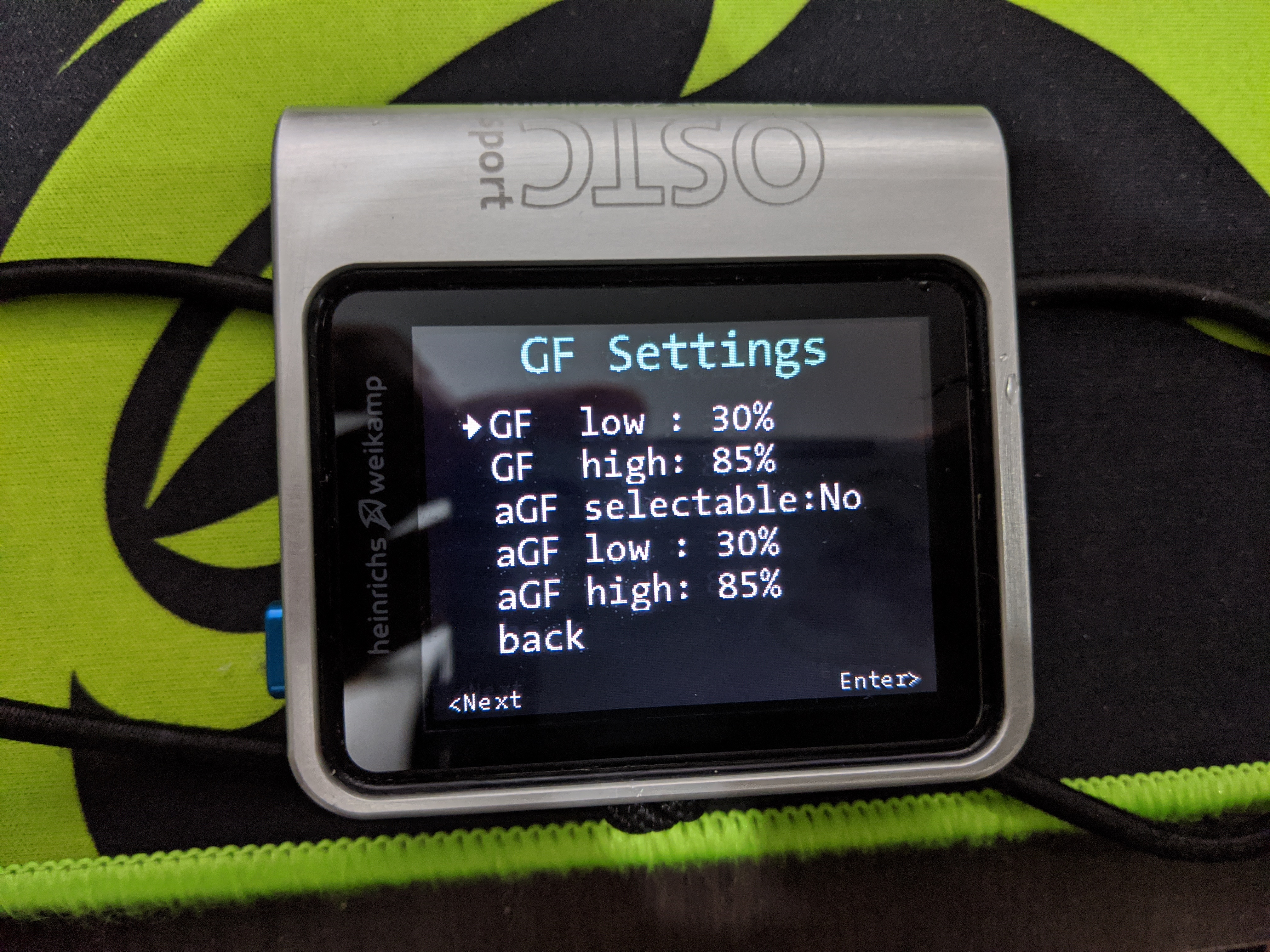

can you provide your settings, especially GFs and sat/dsat?
drakcheslav
Posts: 17
Joined: 09 Jun 2020, 15:48
Re: OSTC Sport gave me a stop on a Non Deco dive at 3m for 3min
Post by drakcheslav »
Everything was set to default. I just updated the setting to include a deco stop.
I'll post images of my settings in a minute
Edit: I've attached the settings
