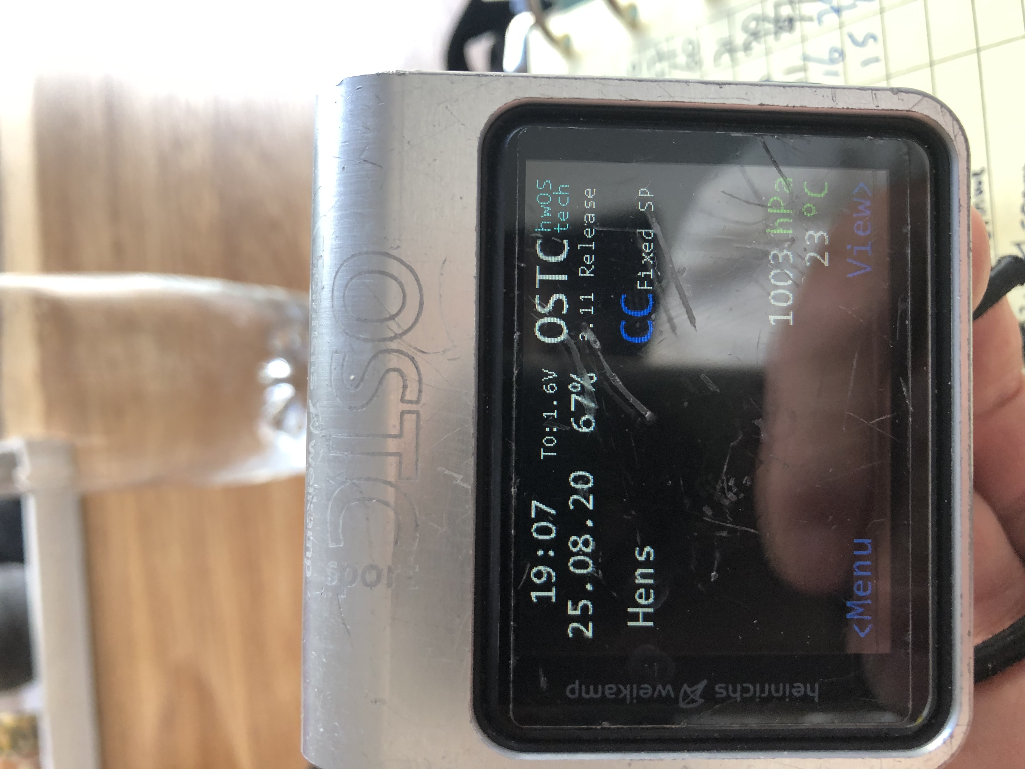

Here is the data I could find
The strange thing is that the dive and the one after the restart is not in the logbook

As far as I understood it (please correct if wrong): this device calculates the % display from the voltage. Some other OSTCs have a charge counter built-in (OSTC plus, 4) and show the % as a remaining charge. So the % display looks the same in OSTC plus and OSTC sport, but the meaning of the % number is different (sport: voltage, plus: remaining charge), and it's not mentioned in the documentation.
The pictures above show 1.61V and 67%. This doesn't fit together, 1.61V should be 100%, and 1.37V should be 67%. But it could happen if the voltage temporarily dropped because of a bad contact; for a split second it dropped to 1.37V, the % dropped to 67% and stayed there. The % display doesn't go up again when the voltage goes back up to 1.61V.
I think Energizer Lithium are a good choice especially in cold water. But you have to be careful that their voltage drops fast when they go empty. So it takes many dives to go from 100% to 75% (1.4V), and then it goes much faster from 75% to 0% in maybe 5 dives.
