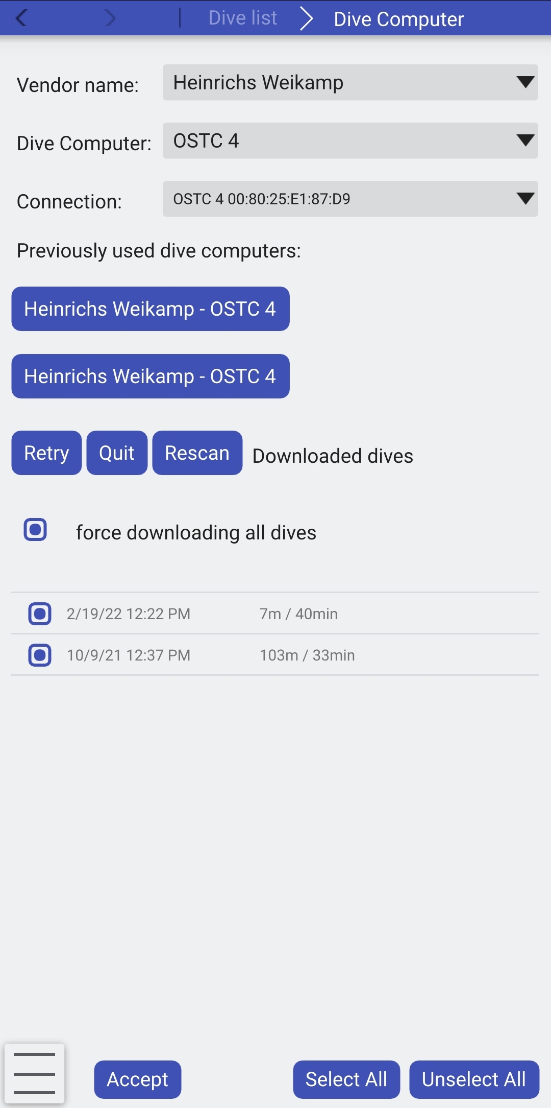

For some reason I can't attach the photos so I had to put them to my onedrive: https://1drv.ms/u/s!AgyZs4MSaiIHjqY0j8 ... ?e=2aqBZ4
I have the latest firmware. Just bought the OSTC4 at the end of last year and first time dived with it a week ago because I was not qualified to go under the ice till last weekend.
When I try to download the last dive with mobile subsurface, I get nothing even the bluetooth connection is established successfully.

Mobile subsurfaca force download only downloads two dives.

LOG: 65 bytes read, last byte is 4D
LOG: finally
LOG: lastbyte (64) is 0x4Dis READYDONE.
LOG: ReadVersionIdentityFromDC
LOG: send byte 0x6A
LOG: recieved byte 0x6A
LOG: now start recieving 2 bytes.
LOG: 2 bytes read, last byte is 4D
LOG: finally
LOG: lastbyte (1) is 0x4Dis READYDONE.
LOG: ReadHardwareDescriptorFromDC
LOG: send byte 0x61
LOG: recieved byte 0x61
LOG: now start recieving 65537 bytes.
LOG: 65537 bytes read, last byte is 4D
LOG: finally
LOG: lastbyte (65536) is 0x4Dis READYDONE.
LOG: ReadAllProfileHeaderFromDC
LOG: send byte 0x66
LOG: recieved byte 0x66
LOG: send byte 0x00
LOG: now start recieving 12347 bytes.
ERROR: 3290 bytes read, last byte is 00 Errorno: 9997 Errormsg: Timeout during operation
LOG: finally
LOG: lastbyte (3289) is 0x00is NOT READYDONE.
LOG: ReadOneDiveFromDC
LOG: send byte 0x66
LOG: send byte 0x01
LOG: now start recieving 13425 bytes.
LOG: finally
LOG: send byte 0x66
LOG: send byte 0x02
LOG: now start recieving 7020 bytes.
LOG: finally
Found 0 dives on disk.
Found 0 dives in profile.
Saved 0 dives to disk.
