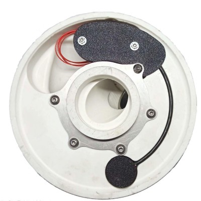

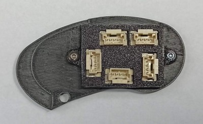

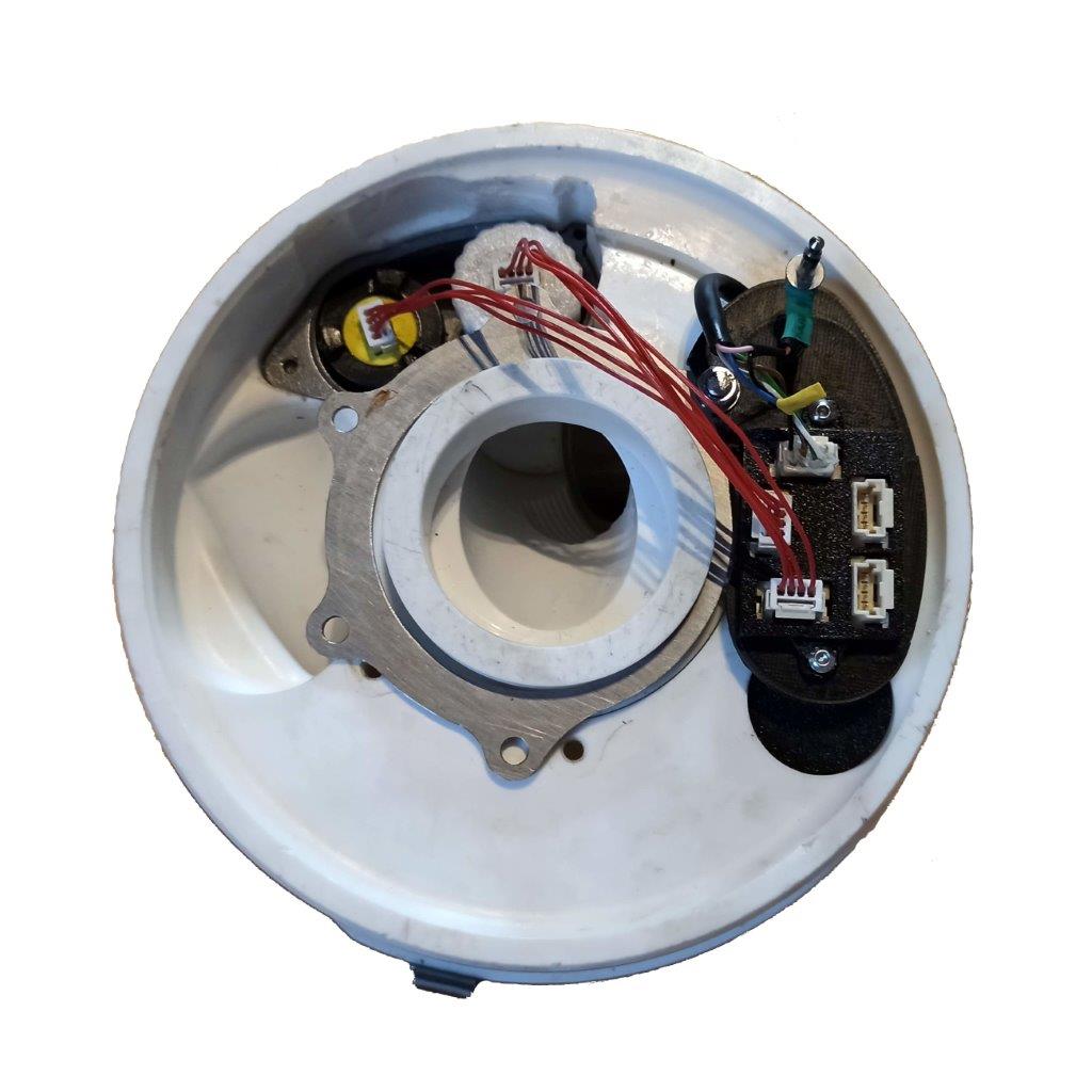

the multiplexer support is part of the last released software (1.6.5 / 3.20). I attached some pictures showing my upgraded Habanero. All you need is an adapter case for the PCB (in this cases 3D printed). Beside the 4 pin connectors you can see a jack plug which is for legacy sensors. Of course it is possible to run digital with analog sensors in parallel.
The sensor slots are polled by the OSTC4 (Master - Slave) that is why reading the sensor by just plugging the HUD into another slot will not work. The OSTC4 could forward the data to the HUD but that would not be a 100% independend backup solution. In general the OSTC4 is needed to operate the multiplexer.

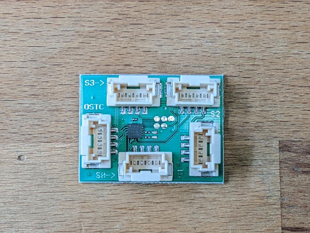

Hello,heinrichsweikamp wrote: 13 Apr 2023, 11:39 Hi,
This will require additional electronics in your rebreather head. We have such electronics developed already but it's still being tested and is not yet supported in the OSTC 4 firmware.
Power will be supplied from the OSTC 4 for all sensors. It has more then enough battery capacity for things like this.
is there an update on the UART multiplexer board? Will it be available in the near future?
Best,
Glenn
- Posts: 4520
Re: OSTC 4 with 3x Solid-State Sensor
We habe this part on stock. Just contact us via email if you need one of these: info@heinrichsweikamp.com
