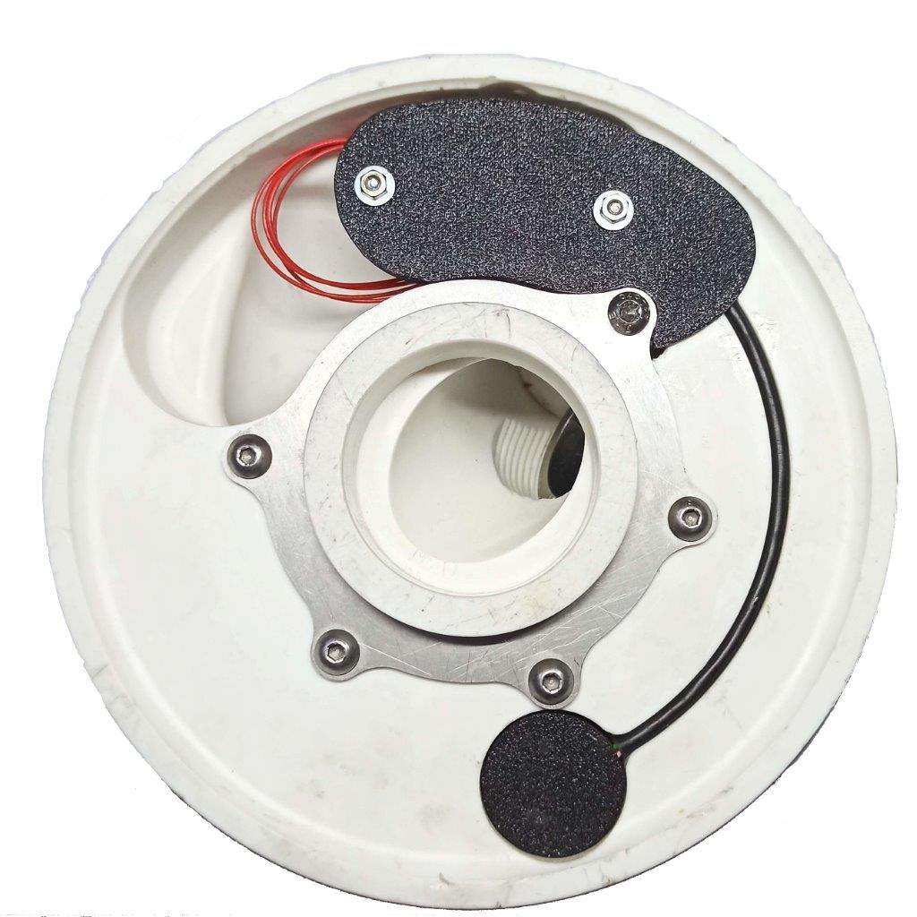

the multiplexer support is part of the last released software (1.6.5 / 3.20). I attached some pictures showing my upgraded Habanero. All you need is an adapter case for the PCB (in this cases 3D printed). Beside the 4 pin connectors you can see a jack plug which is for legacy sensors. Of course it is possible to run digital with analog sensors in parallel.
The sensor slots are polled by the OSTC4 (Master - Slave) that is why reading the sensor by just plugging the HUD into another slot will not work. The OSTC4 could forward the data to the HUD but that would not be a 100% independend backup solution. In general the OSTC4 is needed to operate the multiplexer.
