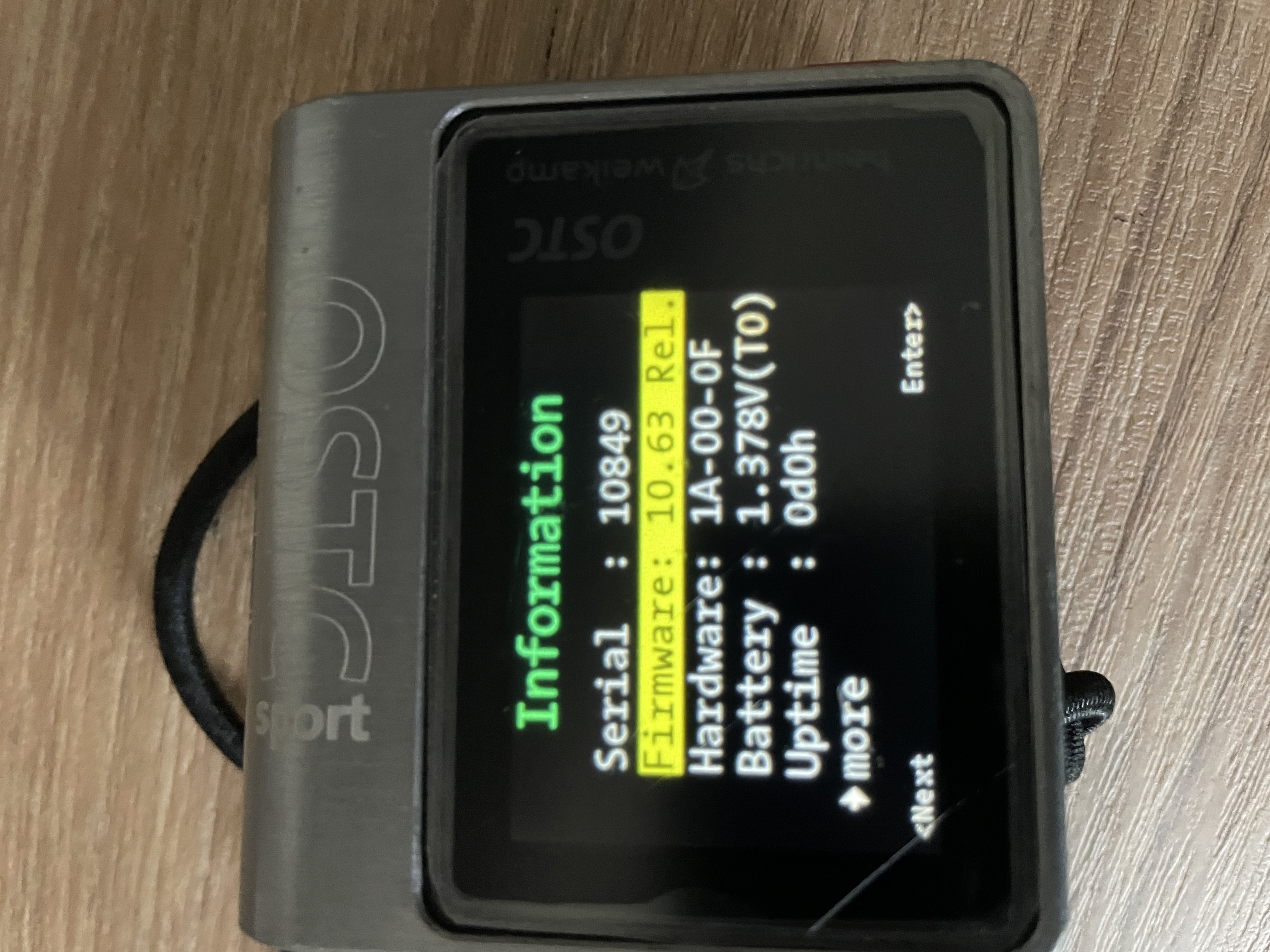

Thanks in advance for helping. I have a unit of OSTC sport stuck with old firmware and is unable to connect to Bluetooth for firmware upgrade.

Apologies, the message was posted before attachments are added. Any help is most welcome. Thank you

Your OSTC sport is from 2014 or earlier and does not support BLE/Bluetooth 4.0
That rules our any of your iOS units (See FAQ for details) and likely your newer MAC Computers. HWOS Config on Android should work, though. Or a Windows PC.
