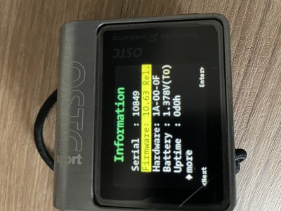

Thanks in advance for helping. I have a unit of OSTC sport stuck with old firmware and is unable to connect to Bluetooth for firmware upgrade.
I have tried the following devices
1. Apple IPad Pro M1 OTSConf
2. Apple New iPad
3. iPhone 12 Pro
4. MacBook Pro (intel chip)
5. Android HWOS

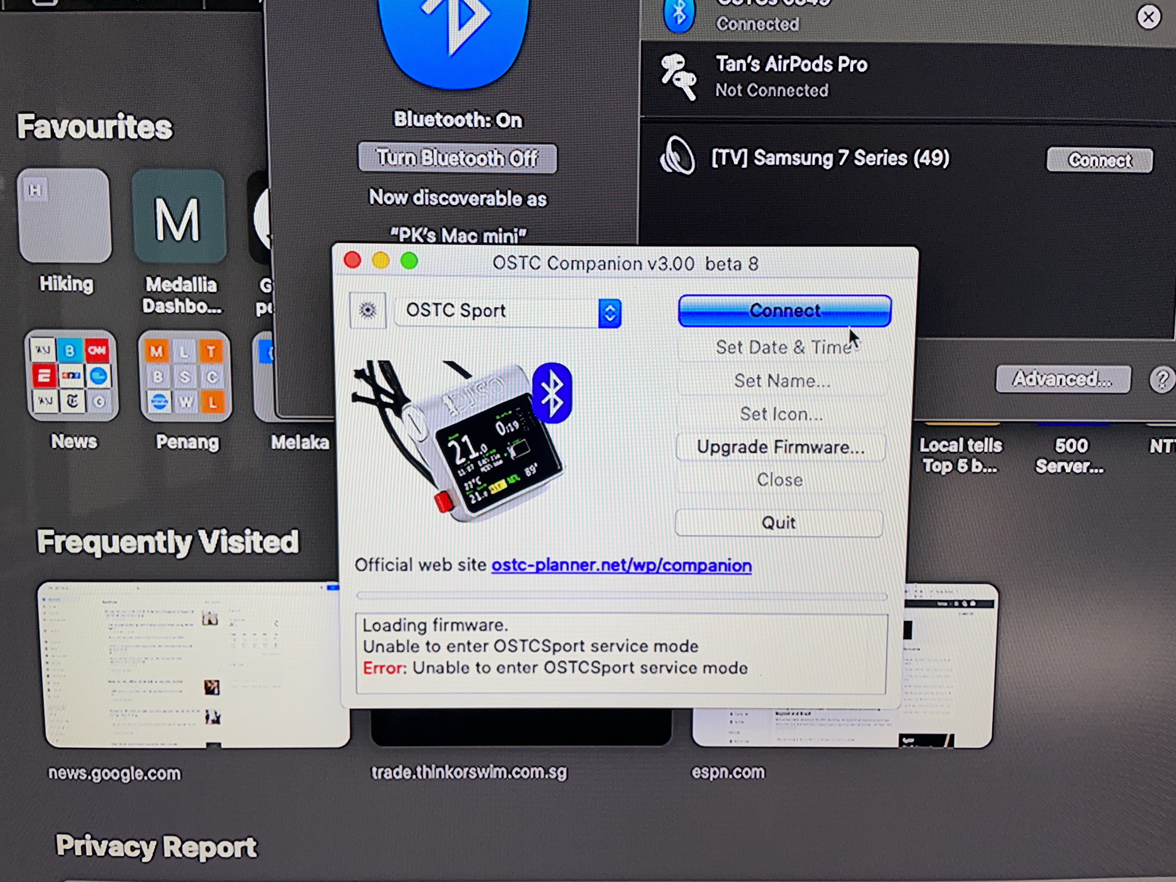

4. Mac Mini 2012 on intel chip. For this one, Bluetooth can detect & connect with OSTC Sport but OSTC Companion is unable to connect for firmware upgrade.

Your OSTC sport is from 2014 or earlier and does not support BLE/Bluetooth 4.0
That rules our any of your iOS units (See FAQ for details) and likely your newer MAC Computers. HWOS Config on Android should work, though. Or a Windows PC.

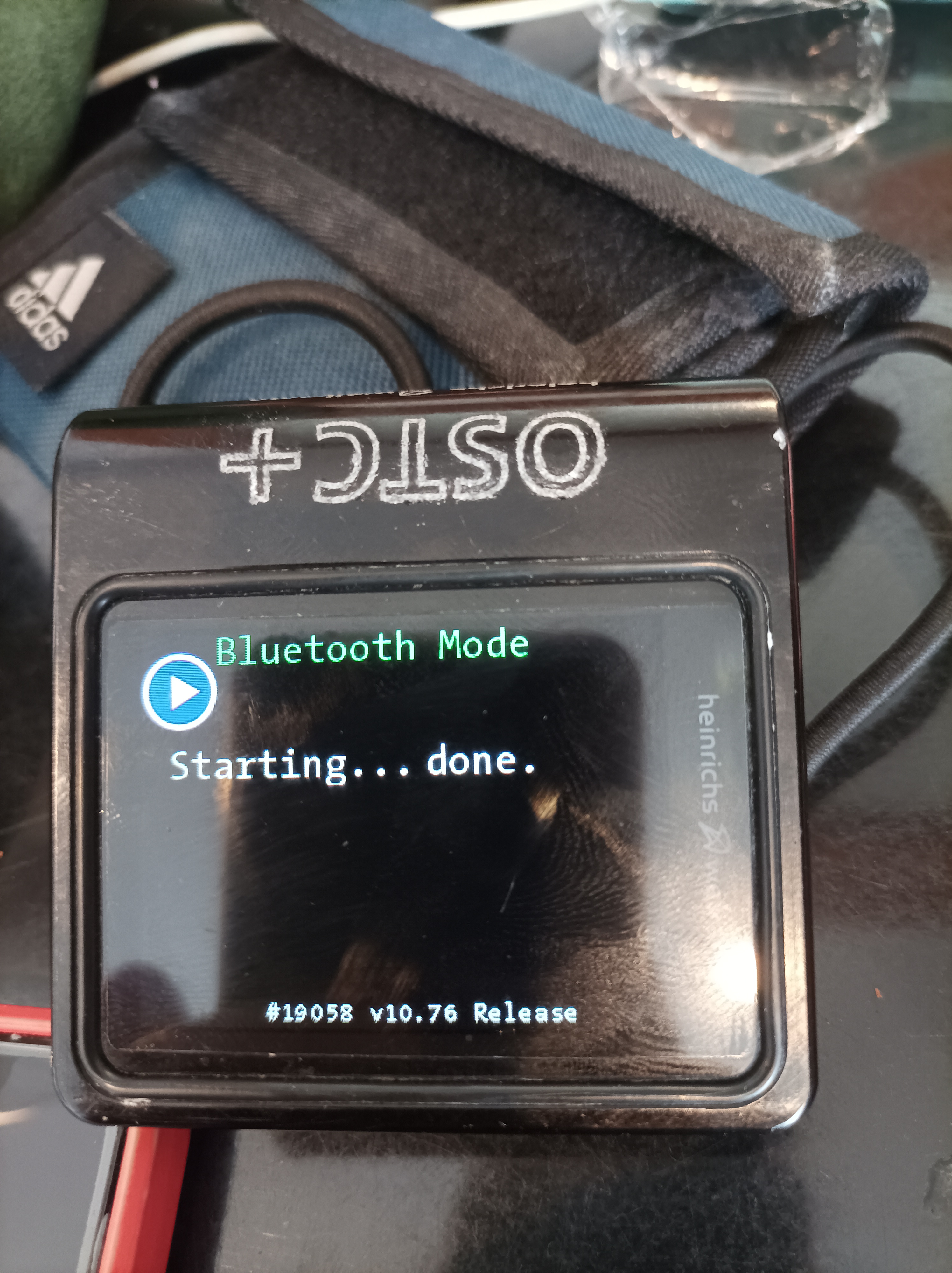

I also tried and cannot connect my Ostc+ to Bluetooth. Secondary problem right now but could not be seen by y PC, iPhone or Samsung phone. I wonder how to update the firmware

Yes, turned it on but not seen by any device

Starting......done but not seen

Your device is already on FW 10.76...
...what are trying to do?

In the new OSTC+, there is an option "Reset Bluetooth" in the reset menu. This will un-pair any devices from the OSTC+ and usually does the trick if you have issues. Also, the OSTC+ Bluetooth may not work with a (low quaility) 1,5V battery. The recommended 3,6V rechargeable LiIon battery or a good quality 1,5V battery as the Energizer E2 Lithium 1,5V is fine.
