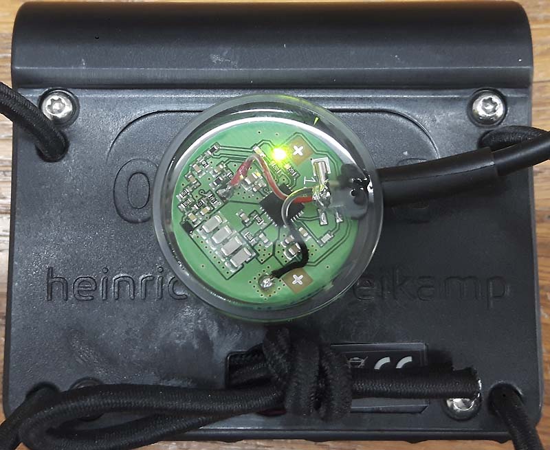

- Posts: 4495
Re: TC switched to bootloader
We have a backplate for the newer OSTC 4 (2020 and later) with a recess for the charger.
But you can see the orientation in the attached image.
attachment=0]positionierung.jpg[/attachment]

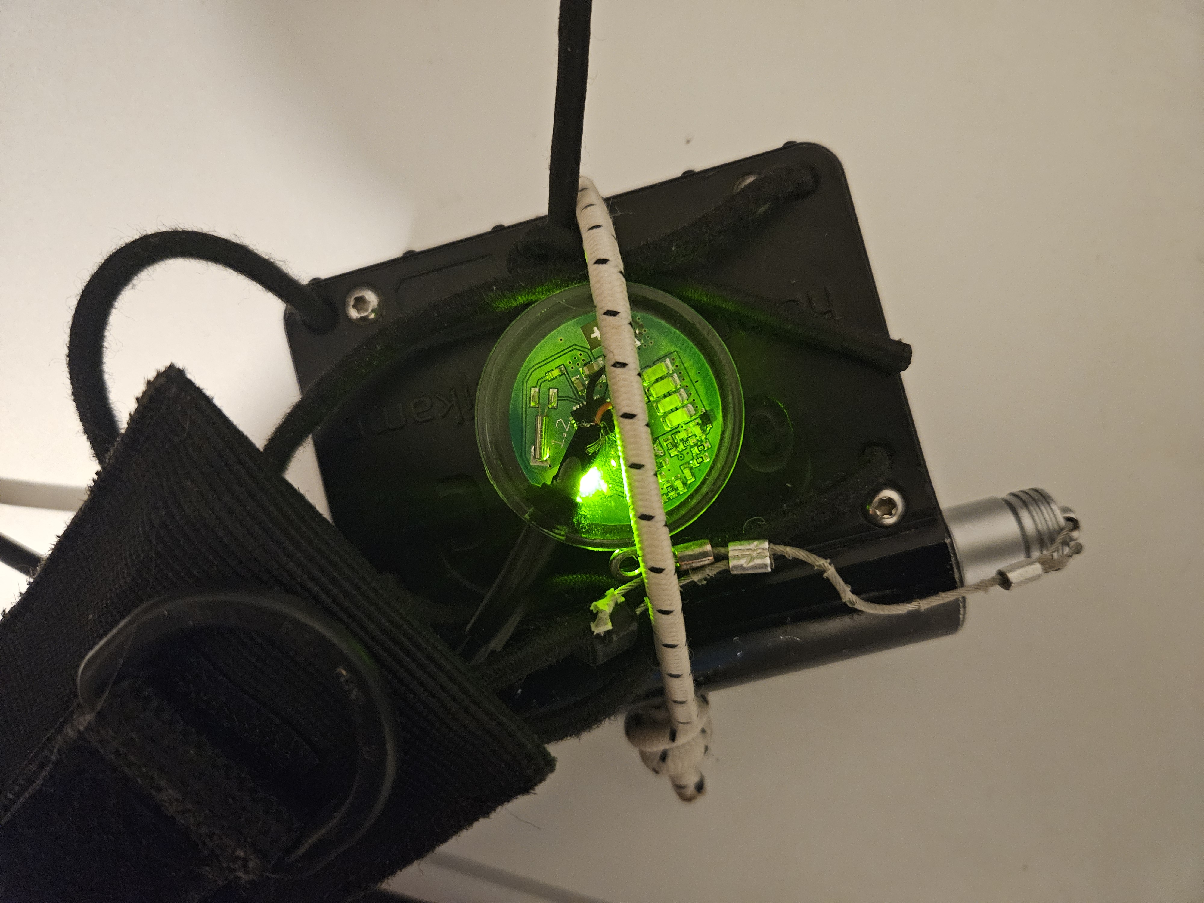

- Posts: 849
[attachment=0]20231116_204653.jpg[/attachment]
So klapps problemlos.
