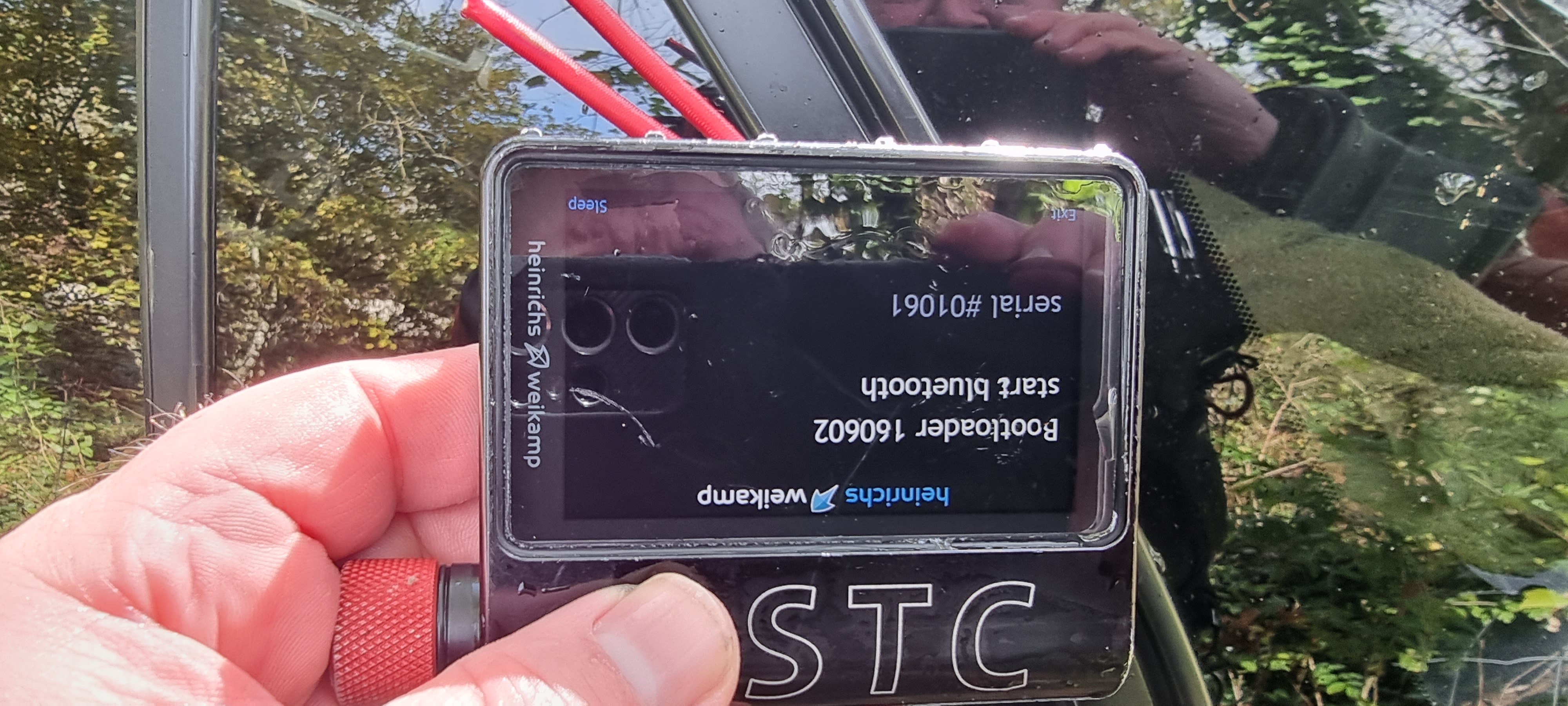

My OSTC4 loaded over night from 3.6V to 4V and I could set O2 content for the gas before the dive.
In the water it switched unintentioally to Bootloader mode and suggested to start bluetooth. Dislpay was upsideddown an pushing the buttons 'Exit' or 'Sleep' did not react.
What can I do tu wake up the TC?

Press "Exit" to start the unit normally.

This was my first intention and try - unfortunately nothing happens by pressing any button

3 Options: Connect with "OSTConf" App and check/update firmware, hard reset with a magnet (Put on charger, trigger the reset with a magnet on the left housing side (or right if you have flipped the screen) or remove battery and re-insert it.

But first do a hard Reset with the magnet...
...and yes to remove the battery you have to unscrew the cap of the battery compartment.

Thanks for the suggestions - the magnet did the trick.
OSTC4 is back alive - voltage again at 3.6V - as we are not diving today, I'll leave it with the charger.
What could have been the reason for the TC to freeze?
Do I have to expect this behaviour in the future as well?
