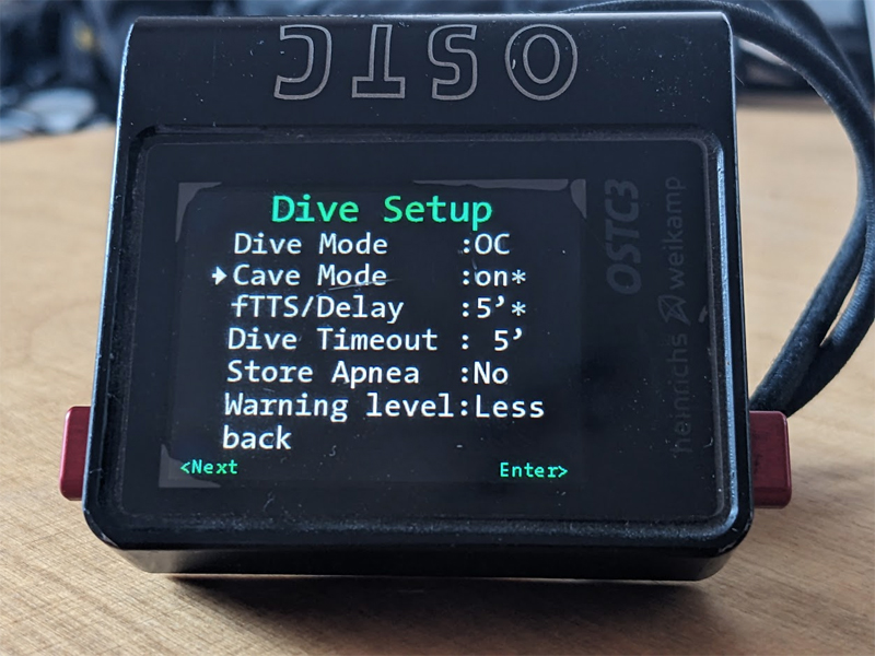

The operation of the cave mode is relatively complex and complicated. Due to the small user base, it is simply better for our support if this is not (currently) in the regular firmware. Here is the current manual, which also clearly shows the functions:
Supplemental Manual for the Cave Mode Function (V1.0)
The intended use of hwos Cave Mode is to monitor if the gases that are carried
by the diver are sufficient to end the dive, especially taking into account the
amount of gases that will be needed to finish decompression stops.
The Cave Mode function extends the normal deco and gas needs calculating made for
open water vertical ascent, by tracking back the whole depth profile of the dive
and including final and/or intermediate deco stops that may become necessary.
The cave mode function may be used in OC diving as well as in CCR/pSCR mode. When
using it in CCR/pSCR mode, it will calculate the way back in bailout mode.
|| NOTICE:
|| With cave mode switched on, the normal 3 meter step size of deco stop spacing
|| changes to a 1 meter spacing, reducing the indicated required stop time in front
|| of passages that are less than 3 meters shallower than the current stop depth.
In order to produce accurate results, the user has to understand the following
concepts and settings, and has to configure these settings with appropriate values:
- While on the way in, the depth profile will be sampled once every minute. For
the return way calculation, it is assumed that the diver will travel at the same
speed as on the way in and will travel along the same depth profile as on the way
in.
|| IMPORTANT:
|| The cave mode provides capacity for 4 hours of depth profile recording.
|| 10 minutes before storage capacity is exhausted (i.e. after 4 hours), an
|| attention message will be given. When the storage capacity becomes fully
|| used up, the cave mode function switches itself off and a respective warning
|| is shown.
If the cave mode function has switched itself off due to running out of storage
capacity, it can be recovered on exiting the cave: When manually switching it on
again, it comes back on again in turned state (see below), showing gas needs and
TTS as of the position where it had switched off.
- Gas needs for the travel portions of the return way are calculated using the SAC
work rate. While spending time on required deco stops, the SAC deco rate is used.
Both SAC values, SAC work and SAC deco, need to be set by the diver to consumption
rates that match personal rates, taking into account elevated rates due to stress
etc., especially when using the cave mode function for bailout capacity checking.
|| WARNING:
|| If the actual SAC rate is higher than the configured on, or if traveling back
|| slower than on the way in, the real needs will be under-estimated and the
|| diver may run into an out-of-air situation if taking the dive to the limits!
- Every tank needs to be configured with its size and with the amount of pressure
that is in it. The cave function will use these numbers to calculate how much gas
will be available from each tank to be used for the way back.
|| IMPORTANT:
|| For tanks that is breathed from while on the way in, the tank pressures have
|| to be set to the turn pressures that have been determined for the respective
|| tanks during dive planning!
- While on the way in, the cave function constantly recalculates how much gas from
each tank will be needed to exit the cave. Upon reaching 70% utilization on any
tank, an attention message (color-coded in yellow) will be given. Upon reaching
100% utilization, a warning message (color-coded in red) will be issued.
- In case Dive Setup -> SAC Setup -> Swap on empty is set to yes, at the time a tank
is calculated to be fully used up, the calculations will try to switch to another
tank that still contains some gas according to the calculations. If such a tank
exists, the remaining way out will be calculated based on this tank and hence on the
gas in that tank, which may be sub-optimal in terms of decompression. If such a tank
does not exist, or if the swap-function is set no 'no', the remaining gas needs will
continue to get added on the depleted tank, resulting in displayed required tank
pressure higher than configured pressure available.
- When turning the dive, i.e. upon starting on the way back out of the cave again,
the cave function needs to set into 'turned' state. This will stop the cave function
to assume that the actual way out is still part of the way in and subsequently will
stop taking further depth recordings and figuring them in for gas needs calculation.
|| WARNING:
|| The diver shall turn the dive ultimately latest when any one of the gases
|| calculates to be fully needed! In this situation, the diver will be without
|| any reserves! It is advised to set the tank pressures a bit lower than their
|| actual fill pressure is, and to set the SAC rates a bit higher, to put the
|| calculation results onto the safe side.
- When setting the dive as 'turned', the indicated gas needs are likely to still rise.
This will be due to the fact that the cave function still calculates the gas needs
for all the way back from turn point to the surface, not knowing how much of this
way has been traveled already. In consequence, the tissue saturations that are gained
on the portion of the way back that has already been traveled are calculated twice,
resulting in an increased estimated deco obligation at the end of the dive. This
effect can be overcome by using 'waypoints' (see below).
|| IMPORTANT:
|| Without having set at least one waypoint (see below) before setting the dive
|| as turned, it is not possible to revoke the 'turned' state again!
- When the cave mode is switched off, the gas needs calculation reverts to the open
water vertical ascent mode, i.e. no dedicated time for horizontal movement is
figured in any more. It is appropriate to switch off cave mode when the remaining
horizontal movements (further swimming out of the cave) can be done in parallel with
doing the decompression "stops". This way, calculation results will become independent
of the remaining way to go, and thus accurate again.
|| NOTICE:
|| When being back near the cave entrance, with only final decompression stops
|| remaining to be done, and with the remaining way being doable while doing the
|| decompression stops, it is appropriate to switch off the cave mode.
- The cave mode function can be switched off and on again at any time of the dive.
Temporary switching off the cave mode while the dive is not set as turned yet can
be used to pause the recording, e.g. while undertaking some tasks that take time
on the way in, but not while on the way out, e.g. fixing the line or doing survey
tasks.
- To tell the cave mode calculations where the diver is while on the way out, waypoints
can be set while on the way in. Initially on setting the dive as turned, the gas needs
are calculated for the full way back. Then the diver can select one of the waypoints
and the cave mode function will calculate how much gas will be needed to return from
this waypoint. Upon physically reaching the respective waypoint, indicated gas needs
will become accurate again for this position in the cave, given that the rules discussed
above are obeyed.
|| IMPORTANT:
|| Waypoints should be set at regular distances and/or important features in the cave
|| profile, e.g. at places where intermediate deco stops are expected. While on the
|| way back out of the cave, whenever a waypoint is reached, the cave function shall
|| be updated to this waypoint. This way the indicated gas needs will always stay near
|| the expected real needs, but on the safe side, given that the rules discussed above
|| are met.
|| IMPORTANT:
|| The cave mode function provides for 30 waypoints. Every waypoint that is set
|| reduces the available storage capacity by the equivalent of four minutes of depth
|| profile recording time. Thus, when all 30 waypoints are used, the depth profile
|| storage capacity reduces to 2 hours for the inwards part of the dive.
|| IMPORTANT:
|| To establish a relationship between the numbering of the waypoints within the cave
|| mode function and their physical positions in the cave, it is recommended to place
|| cookies that are marked with the respective waypoint numbers.
- Every time a waypoint is set, also a marker will be set in the normal logbook recording.
- If at least one waypoint has been set, the 'turned' state of the dive can be revoked
again. To revoke the turned state and thus continue the dive in inward direction, the

Operating the Cave Mode Function:
The Cave Mode Function is activated by setting the the surface menu item
Dive Setup -> Dive Setup (again) -> Cave Mode to 'on'
It will then be active right from the start of the following dives. All further
operation is done during the dive via a dedicated cave mode menu. This menu can
be accessed via the left button: after pressing the left button for 'Menu?',
press it again to show up 'Cave?', then press the right button to enter the cave
mode menu. In OC mode, the cave mode menu is also reachable via the main dive menu,
using the menu item 'Cave Mode'.
