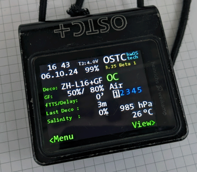

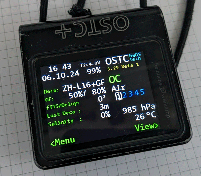

We haven't released a beta version for a while. Recently, however, we have put some work into a slightly revised colour scheme and this can now be tested.
The dark blue colour in the interface menu is now only used for inactive gases, the decoration type (in this case OC) and the menu labelling are now green. This makes them easier to recognise on the surface even in brighter ambient light. The ‘Custom Views’ in the surface menu have been rearranged. Values in white, labelling in green. The beta is attached to this post. An hwOS TECH OSTC is required to install it. A downgrade to the current 3.24 stable is possible without risk or data loss.
[3.25]
MD5: fe06fc97521fb66b41d76ac7c4b25cf7
BETA release, EN, TECH, CAVE, external Interface (Can ONLY be installed on hwOS TECH OSTC!)
CHANGE: New colors in surfacemode
CHANGE: Alignment of information in surfacemode improved
BUGFIX: With straight Bühlmann a stop @ 0m was shown in certain conditions (Instead of 240' NDL time)
BUGFIX: A faulty work-around for a silicon bug did not wake-up some OSTC 2 in very rare cases (Only for CPU rev 0x05)

Hi Matthias,
Beta release 3.25 loaded and explored (on surface), looks better for me.
