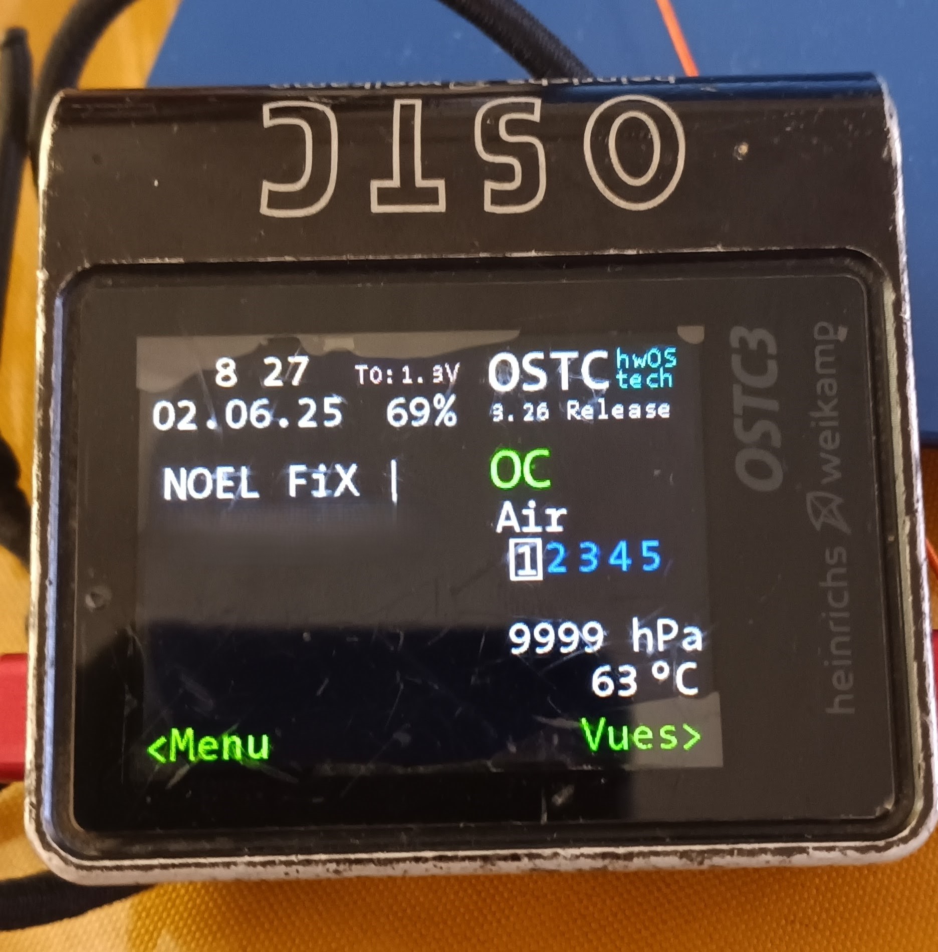

Hello, I'm having a problem with my OST 3. The pressure/temperature sensor no longer seems to be working and displays a pressure of 9999 hPa and a temperature of 63°C upon startup.
Is a repair possible?

Email HW. Most probably the pressure sensor is defect.

it's an old one no bluetooth
serial nb 2273
fxn
serial nb 2273

Due to unavailability of parts we can replace the pressure sensor in the old USB OSTC 3 anymore.
