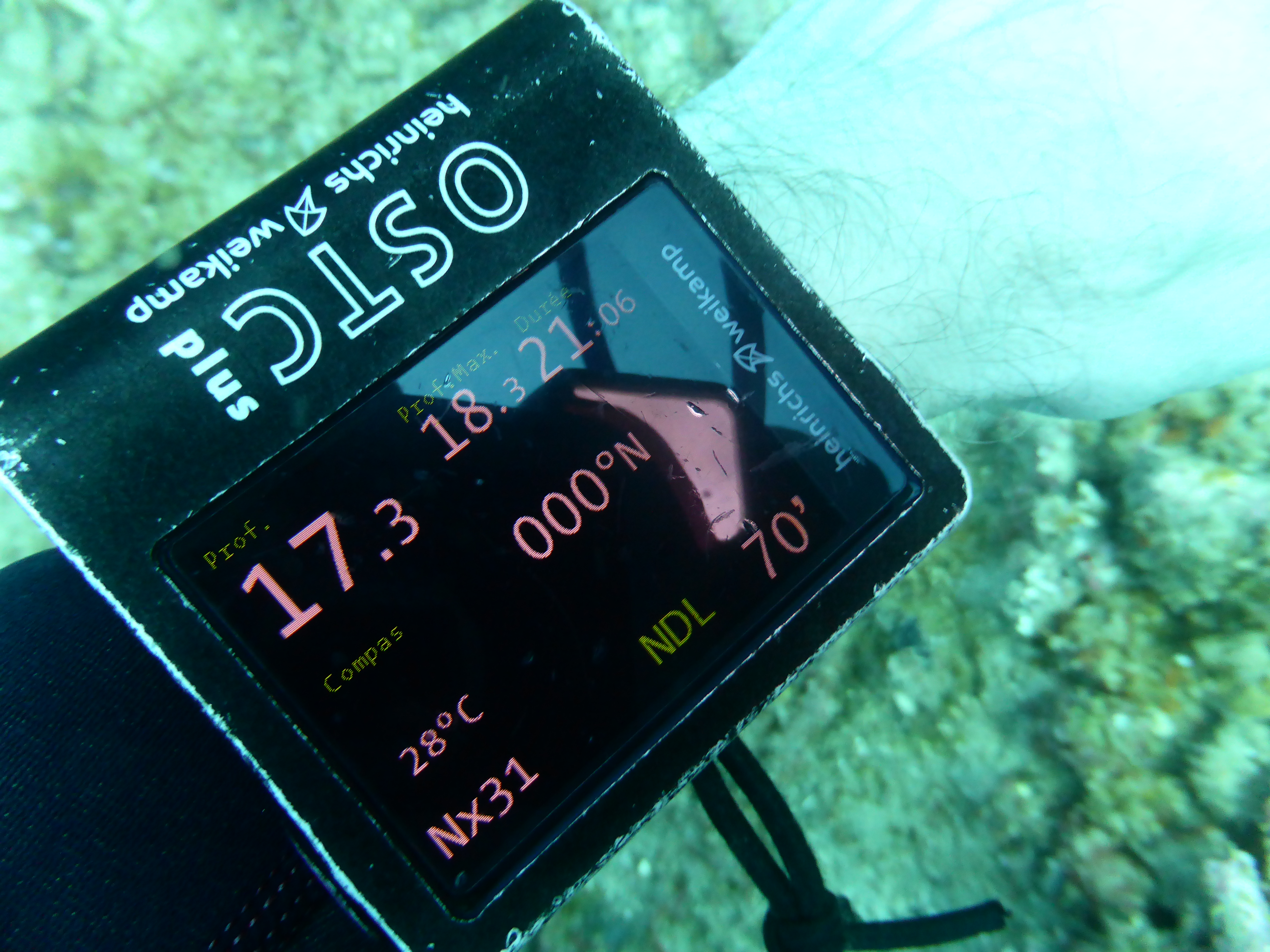

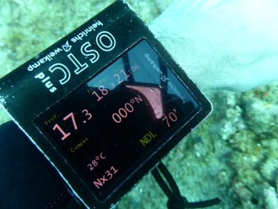

Compas shows 000 when under water ( it works well on the surface)

fixed in the 3.34...
[3.34]
BUGFIX: Compass showed 000 when dive mode was started out of sleep mode

Thank you for the response. I’ve installed version 3.34, and now the compass works underwater.
However, it’s a pity that the display only shows a number in degrees. The previous analog display was more ergonomic.”
