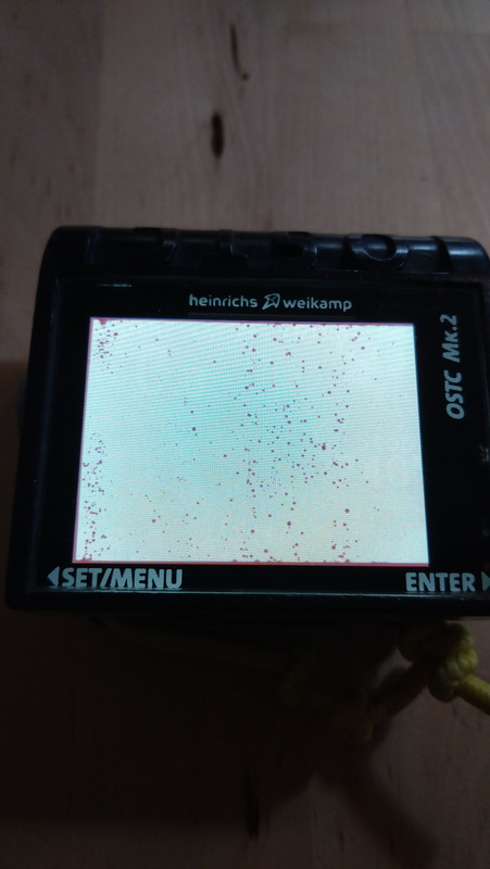

This is what the screen looks like when I turn it on, then it goes dark again.

Looks like your display died.
I doubt that HW will repair it as they communicated the end of support for 2N and MK not long ago....
Write an email to HW.
Posts: 4535
Re: OSTC Mk2 Screen staying dark
I agree, this looks like the unit is end-of-life unfortunately.

Thanks for the comments.
I did assume it was end of life, and at 14 years, deservedly so. I was just wondering if there was any possibility of getting it to work again.
I've bought a shiny new OSTC2 gen 5 as a replacement, so I'm happy again.
