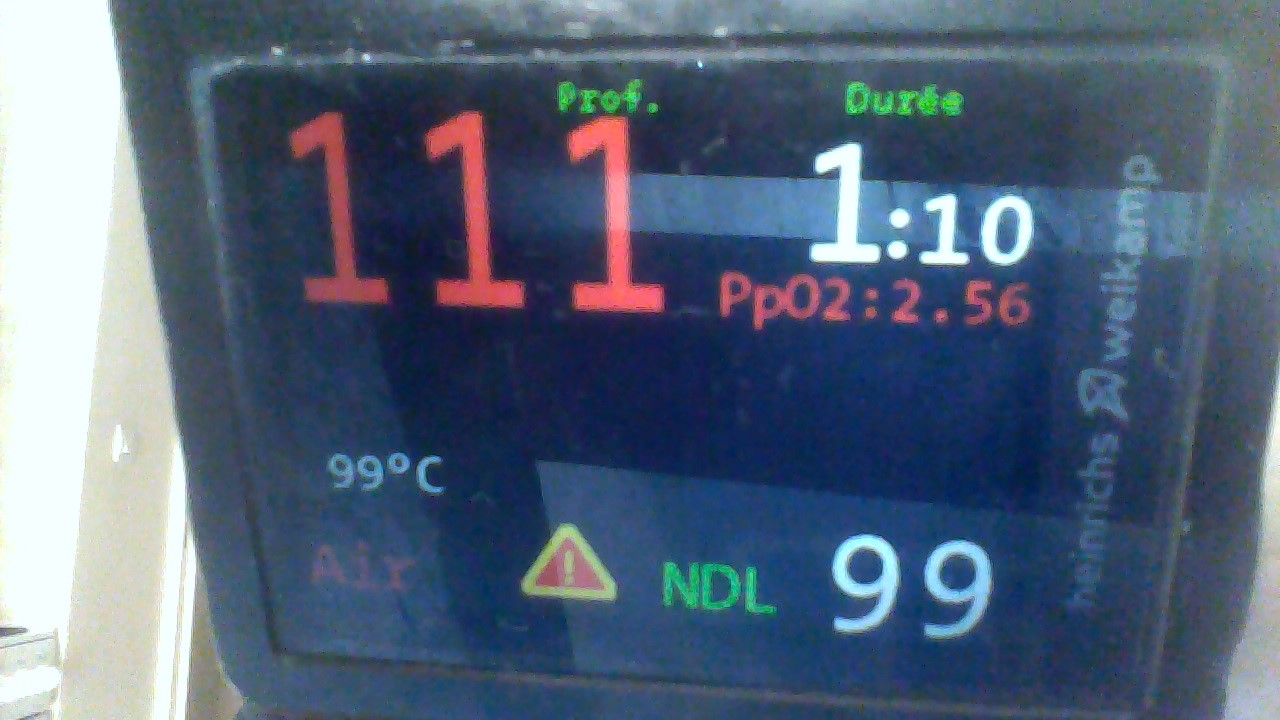

N° 16570 version 10.60 Hardware 13-49-OF
I dived several days without any problem. After my last dive, i put the computer in his box with its charging cable as usually and let it all the night.
On the next morning, when i would check my Ostc Plus just before going to diveI, I saw there was many alarming informations (see attached picture).
I removed and returned the battery twice but without any effect.
I have no more control on the computer.
I am obliged to remove the battery to stop it.
Posts: 754
Re: locked computer
Well, that pretty much looks like a defective pressure sensor (depth = pressure and temperature are corrupted). It's factory repairable, please contact HW by direct email to arrange the details.
Posts: 4511
Re: locked computer
Yes, please email us: info@heinrichsweikamp.com
We have this fixed quickly.
