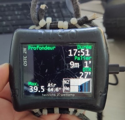

The OSTC only started when I plugged the USB cable. It showed the screen in dive mode buth without the current depth.

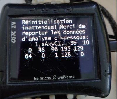

Then, I rebooted the OSTC with the magnet and it showed this screen :

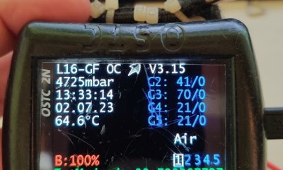

The OSTC showed the main screen but with bad air pressure and air temperature.
After few minutes, the screen switched off and it was not possible to turn on. The only way is to unplug and plug again the USB cable.
I tried to load again the firmware 3.15 but with no effect.
I tried to simulate a dive (66 m, 21') and the result is not what expected : The calculation started from 260 meters and on all the other steps every 3 m.
It showed the dive plan on the following depth : 17, 14, 11, 8, 5 and 2 m. and then 127, 124, ..., 52m. For the gaz volume the result was =xxxx.x

Quite obviously a defect in the pressure sensor. We still have (few) spare parts for the 2N and are still repairing them. Just get in touch with us: info@heinrichsweikamp.com
