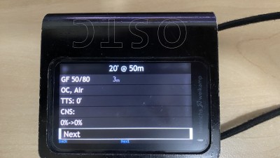

Going from Standby to the Sim Menu and press "Calculate Deco", it shows me no Deco at all. Regardless how often i do this, see picture IMG_4464.jpeg.

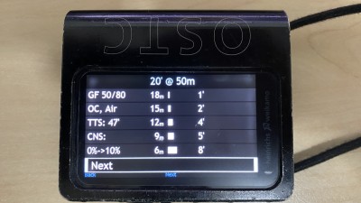

But if i then choose "Start simulator" and immediately terminate the simulation and try "Calculate Deco" again, i get the following result, picture IMG_4465.jpeg.
I can reproduce this every time after wakeup from Standby. I don't remember having this behaviour before. Only thing i did is replacing the battery...

This is known issue of the 1.6.2 and is already fixed: https://code.heinrichsweikamp.com/publi ... 5f9557c053
We have a new release very soon.
