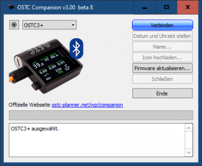

OSTC 3, sport, Plus, cR and the OSTC 2 are updated with the OSTC Companion software:
Download the latest version here:
MAC OS: https://www.heinrichsweikamp.net/downlo ... _3.0_8.pkg
Windows: https://heinrichsweikamp.net/downloads/ ... _3.2_1.exe
Latest 32Bit-Version: https://www.heinrichsweikamp.net/downlo ... 0.21.1.exe
To upgrade, download and unzip the latest firmware for your OSTC device:
Firmware
- Pair (Bluetooth only) your OSTC to your PC/MAC.
- Setup Communication port in the companion (Small gear icon next to computer list)
- Click on "Upgrade Firmware..."(Without clicking "Connect"), browse to the unzipped firmware HEX file and click on OK.
Wait about 1min - Done.

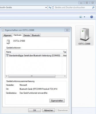

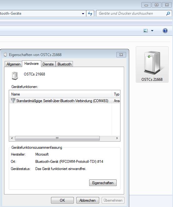

1. Step: Find your OSTC's COM-Port:
After "pairing" the OSTC with your computer with bluetooth, right-click on the OSTC (In the Control Panel\Devices and Printers) and choose "Properties". Select "Hardware" tab. Use this COM port shown here. No need to try other ones.

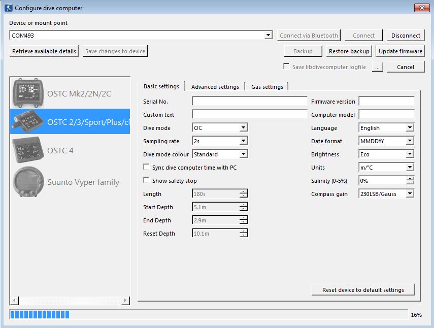

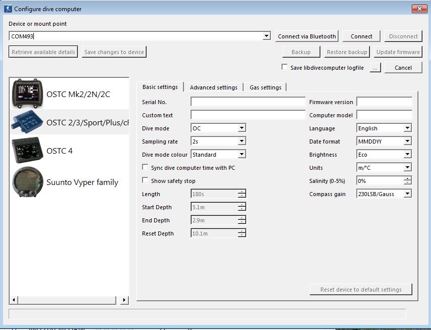

2. Step: Start Subsurface and choose File -> Configure Dive Computer. Start Bluetooth at the OSTC
Select or Enter the COM-Port and click on "Connect". ( "Connect via Bluetooth" is an alternative way without prior pairing)
3. Step: Click on "Update firmware"
Firmware
Choose the downloaded firmware file and click on "open". Wait until this process is done.
Done!

1. Schritt: COM-Port feststellen
Nach dem "paaren" des Computers mittels Bluetooth mit der rechten Maustaste auf den OSTC klicken (Im Menü Systemsteuerung\Hardware und Sound\Geräte und Drucker) und dort auf "Eigenschaften" und dann "Hardware". Der dort angegebene COM-Port ist der richtige. Man braucht also nicht andere zu probieren.

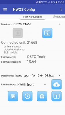

HWOSConfig for Android! Another very simple Method on updating the OSTC with an Android device.
What is implemented:
-Personalizing (setting of Customtext)
-Firmware update for HWOS OSTCs, Tech and Sport.
Supported OSTCs:
-OSTC 2 (new)
-OSTC Sport
-OSTC 3 (April 2015 and later)
-OSTC plus
Permissions:
the App needs
-Read/write access on the device
-Bluetooth access
-access to the internet.
There are no ads, and no data where collected.
Step by step instructions:
Install the App from Google
https://play.google.com/apps/testing/eu ... hwosconfig
-Accept permissions (only once after installation
Select your OSTCType (HWOS Tech or HWOS Sport) and click on download to get the latest firmware.
When you wipe to the right, you can see the history of changes file, provided with the firmware.
-Switch Bluetooth on your OSTC on.
-Go to Android settings, search and connect your OSTC.
-In the App select your OSTC from the combobox (make shure Bluetooth is on)
-click "CONNECT"
The type of the OSTC will be automatically detected and set in the combobox.
-check the type of the OSTC in the combobox, if neccessary change it.
(my OSTC Plus with Tech firmware tells me that it is a sport version, but it isn't, i have to clarify this with matthias)
After connection there is a line shown below the Download Button that tells the Identity of the OSTC (type). Plus users can mail me, or post the line here, together with te type of ostc (tech or sport).
-make shure you have a firmware version selected.
-click on "UPLOAD"
-be patient :-)
Custom Text:
-Select your OSTC in the App
-Click on "CONNECT"
-Click on "CUSTOM TEXT"
-Set the text
-Click "OK"
-Click "DISCONNECT"

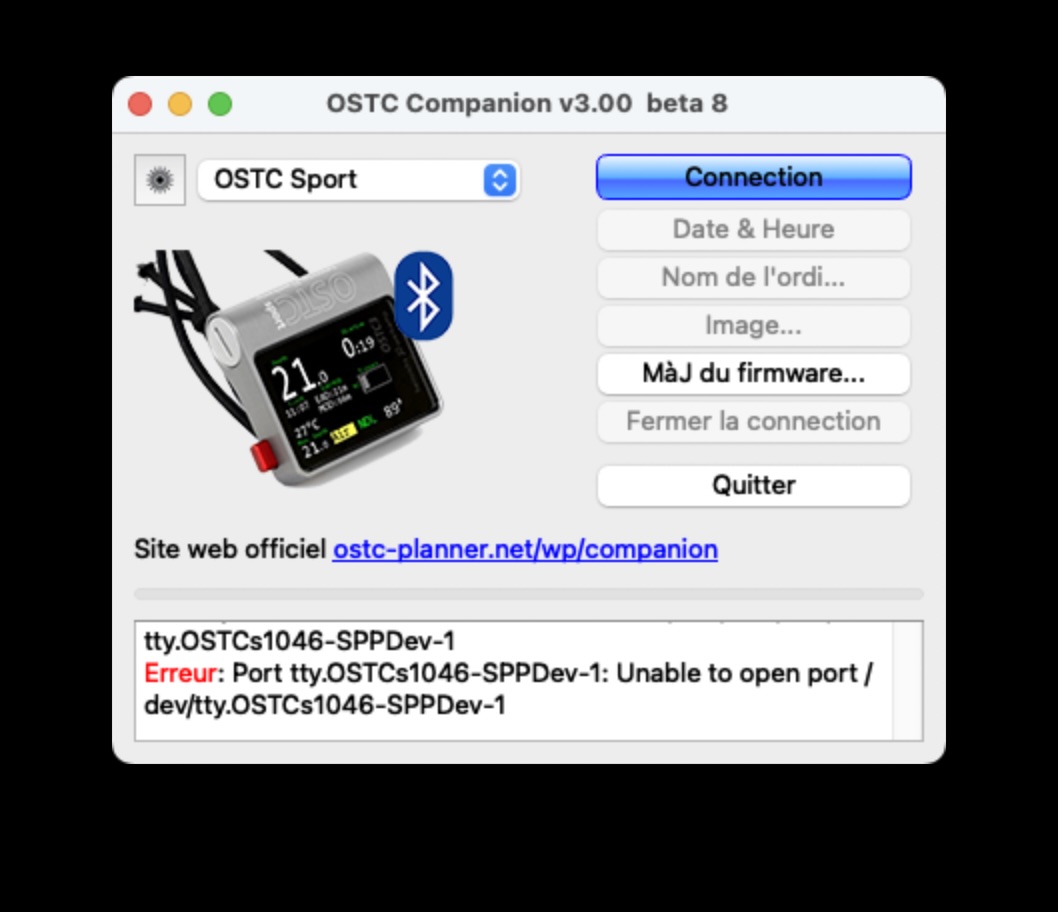

I have an old OSTC Sport that I want to reuse.
It's running version 10.70.
With my iMac (Mac OS 15) and Companion, I get a port error.
With my iPad (iOS 18) and OTSConf, it can't find my computer.
What should I do?
