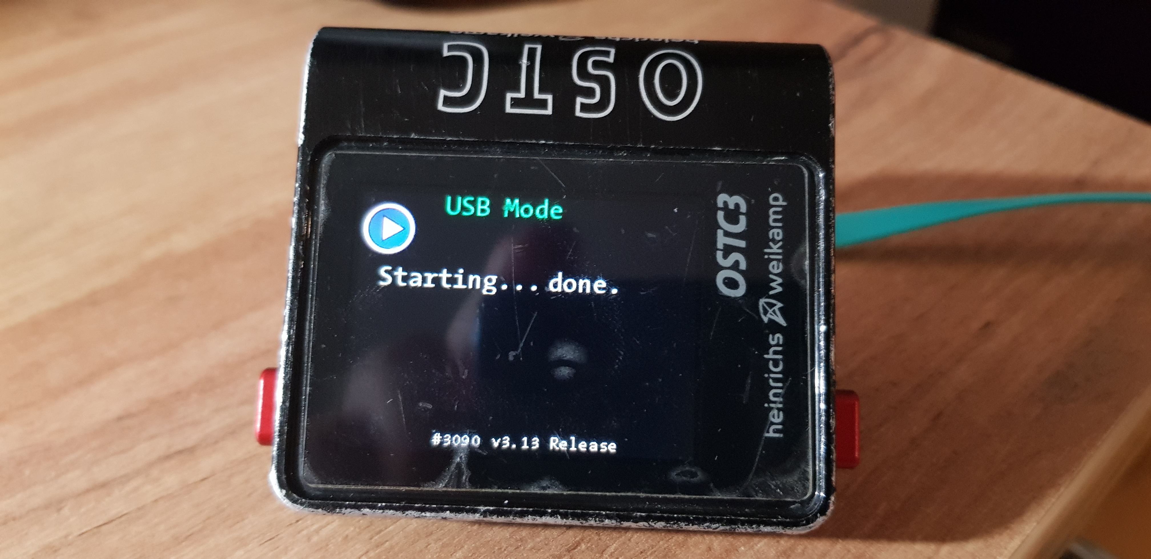

You got it !
Re: OSTC3 problem with data and Bluetooth

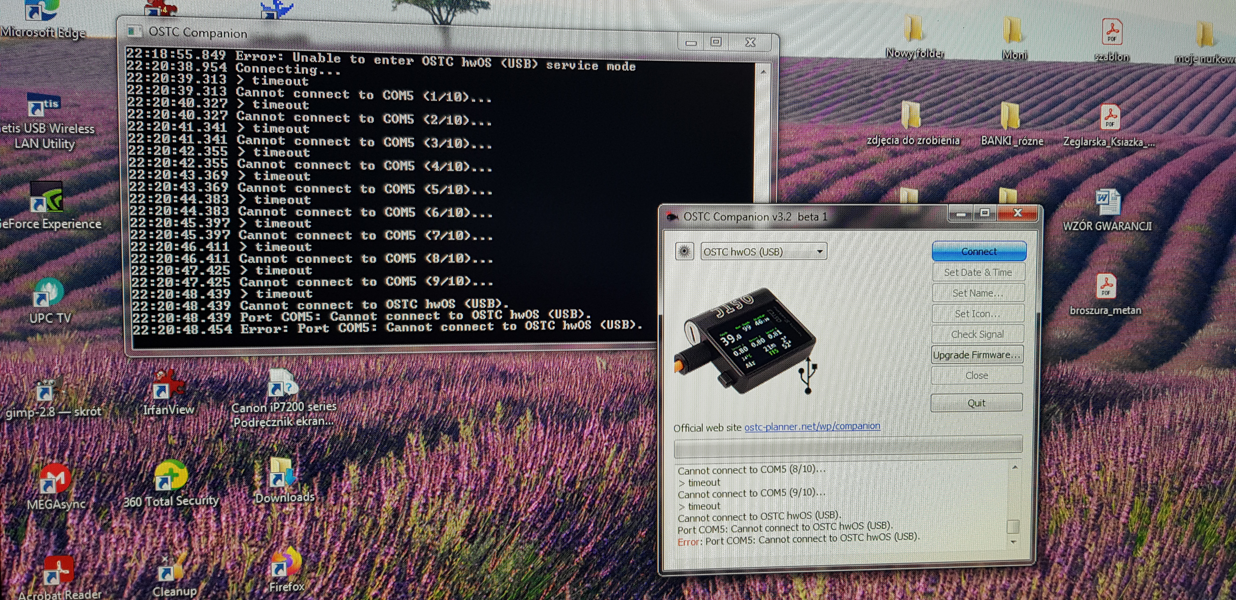

please help..
what am I doing wrong?? can't connect..i've been trying for an hour.
Did you do it??
Did you do it??
How sure are you that this particular USB cable can send data? I’ve seen some that’ll charge things but don’t send data.
Marcomet : are you sure your computer is connected to COM5 and not to another COM port ? Have a look to the Windows peripheral panel.
jb2cool : yes, this USB port is the only way to update the firmware and download dive profiles since there is no Bluetooth on this unit.
Regards.
Regards.

@Marcomet
Have you tried anothercable!?
